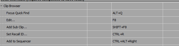

That's correct Simon. Something simple, it would be nice to have this option available.
If you highlight Clip Browser, there's an option to "Run all children actions when group triggered" but I don't want to trigger anything I just want to be able to Open and Close the Clip Browser faster.
Hopefully Ross can later add this option.

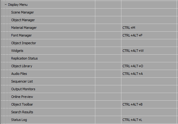

I would expect it to be in this list but it is not.
It also has its own menu but doesn't seem like there is an option to open the menu

Is there a pre-existing hot key or is it possible to create a shortcut to open CLIP BROWSER?

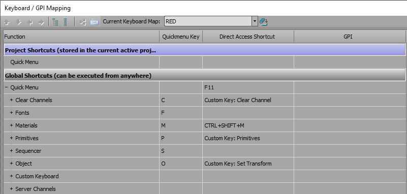

Sent: 08-10-2023 06:30
From: Simon Redmile
Subject: Keyboard Mapping in XPression
So you need to save a mapping profile rather than project for example here I have one called RED.
Anything you add to this global key map rather than project will always be on that machine.
Currently these are saved in the installed folder as kbd files.
I know the product team are working on adding a feature to make these easier to move between machines.
