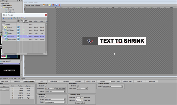

    I'm having trouble executing something that I feel should be simple for me. Cannot seem to figure out how to go about it.
    I've made a super simplified version of what I am trying to do and attached a couple of screen shots.
    I'm creating L3's and I want to have a Logo box on the left of the L3. I want the L3 centered. I will have text groups within the 1 text line, so the line will shrink and grow depending how much info I am sharing. My text is center aligned. I've made the text background a child of the text. I've tried making the Logo box a child of the text too. When I do this, the Logo box does move to the left but it stretches (or squeezes) the logo as the L3 get wider or thinner. I was trying some visual logic but was not having any luck (since my knowledge with that is limited).
    Is anyone able to share an easy process to accomplish this?

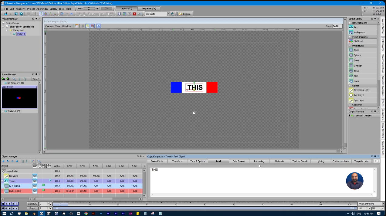

    Hope this will Help You.=>>  How To-40 Ross XPression Follow Boxes X Position كيفية البرنامج التعليمي
    YouTube remove preview
    Tips and tricks on how to achieve your work goals. Using Ross Xpression - كيفية البرنامج التعليمي خدعة سريعة ٣٤ مرحبًا، في هذه الخدعة السريعة، سنستكشف كيفية ضبط ومحاذاة نص Unicode العربي مع التفاف الكلمات. شاهد الفيديو بعناية واتبع هذه الخطوات. سيساعدك هذا في حل مشكلتك الحالية، والتي يمكن حلها بطرق معقدة.
    View this on YouTube >
