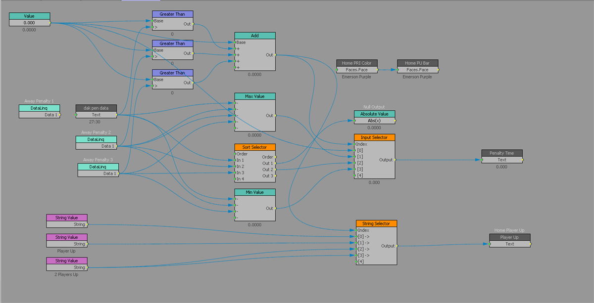

    I think I have it backwards. I am trying to use VL to do a few things;
    1. see if there are any penalty times, if there are one say man up, if there are two say two men up, if there are none, say nothing.
    2. if there are two clocks, show the clock with the least amount of time.
    When I add the clocks in VL either as a datalinq block or as a text object, the selectors either don't see any values or they don't see the value as a number. I tried using some of the timer blocks but they don't seem to see the info as time either. Any recommendations or am I as far as VL will take me?

    Can you show me your visual logic as a screen shot?
  • 7.  RE: Lacrosse/Hockey Scorebug Recommendations
    Posted 03-13-2026 08:49
    It was originally the three datalinq objects on the right that it was selecting from but I tested using a text object with the first penalty time which is why that one is a text object and the other ones are datalinq blocks. The selectors just don't seem to recognize time as a string or a value

    Hey Zach,
    I was able to use your screenshot from above and some other logic I've been working on to get a successful Power Play logic dropdown for our hockey scorebug here at UST.
    I've broken up my logic into 4 tabs: Team, Text, Color, and Animation (attached screenshots)
    Most of the logic is checking for active timers like yours is; however, I've formatted the clock data I'm getting from Dashboard or Daktronics to give XPN a better number value to read by removing the :
    The scene for the Powerplay is separate from our scorebug, but just needs to be taken online. When ALL timers are cleared, the dropdown will take itself offline OR if there is remaining clock data the scorebug will animate the dropdown offline before animating off.
    I've attached screenshots and a video showing the dropdown in action.
    For your timer delay, I'd think you could just use the Add block, but once your timer reaches 0, obviously the add will continuously show "4".
