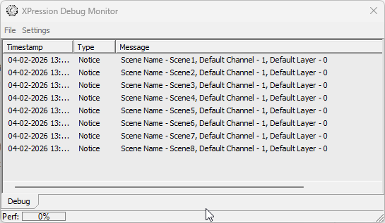

    You can place this script in the Global KeyBoard and GPI Map and assign it a KeyBoard shortcut. When executed, it will look at the Active Project and log Scene information to the Debug Monitor (To enable the Debug Monitor, Edit > Preferences > Advanced > Enable Debug Monitor for scripting). Once the script has been executed, you can right click in the Debug Monitor and save the contents to a text file.

    Brilliant! Thank you, Greg.
