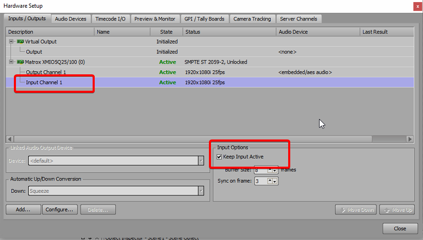

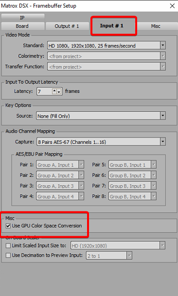

    Posted 05-23-2024 13:31
    Are you using a Matrox card?
    If so, make sure this is enabled in hardware setup for the input:
