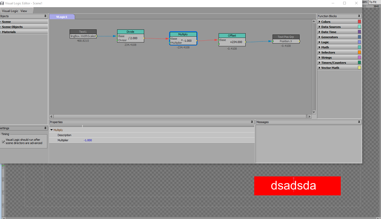

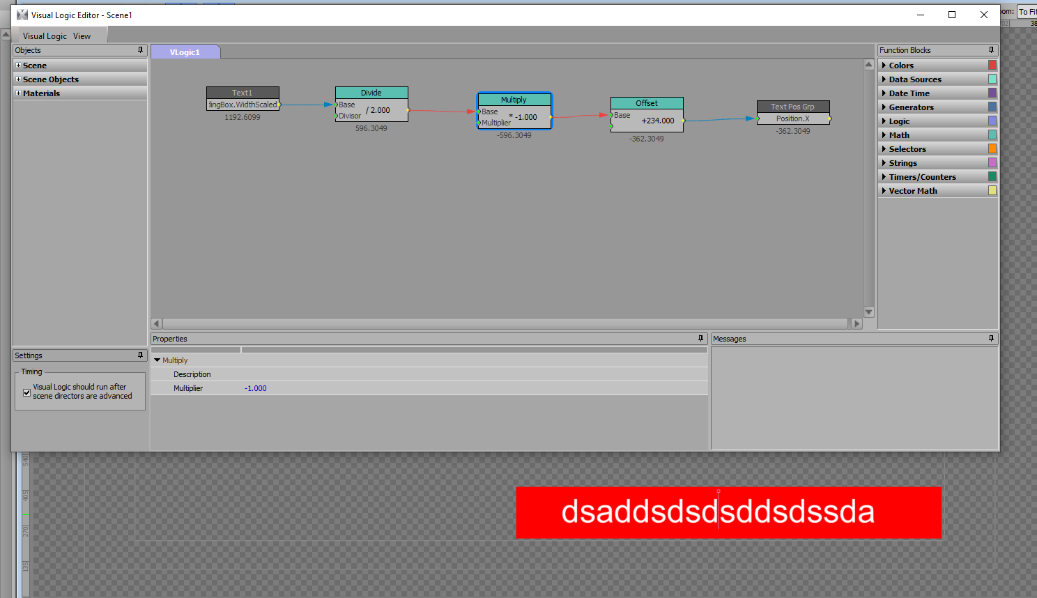

Simon, this worked beautifully. Thank you!

I quickly just made this.

In that case you should move a group with both items in negative X as the size of the box grows, probably about half its width left as it gains size. boundingbox.width divided by 2, multiple by negative 1 so you get minus the value so its moving left with and offset to get the position you want to the X property.
