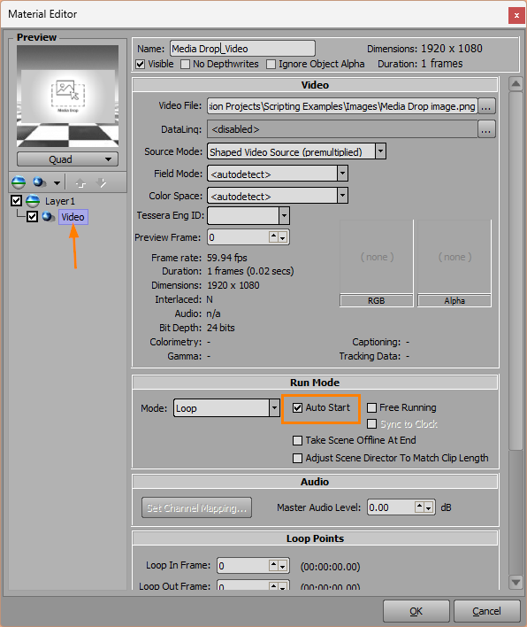

    Here's a good tutorial on Dynamic Materials: https://www.youtube.com/watch?v=rfeXnFgSmPA
    Keep in mind when swapping video materials that aren't originally bound to the scene, you won't be able to play them using the scene director. You'll have to set your video material to Auto Start on the Material's Video Shader Property.
