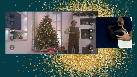

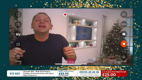

    I have (amongst many others!) a couple of Custom Controls which simply activate a memory recall.  They are designed to be used together using two keyers on MiniME2.
    On one memory, one keyer is visible and centred on the screen, the second keyer is off (to keep the tally off) and positioned off screen on the right.  On the other, both keyers are visible and on in a two box arrangement.  I have attached two images to illustrate.
    Since we upgraded to Version 7 I have noticed that the position change on the second keyer is not seen as part of the transition and this seems to be the case if the keyer changes from on to off.  I was wondering if this is a bug or a change to the behaviour of the effect dissolve?
    Thank you in advance
    Picture 1
    Picture 2
