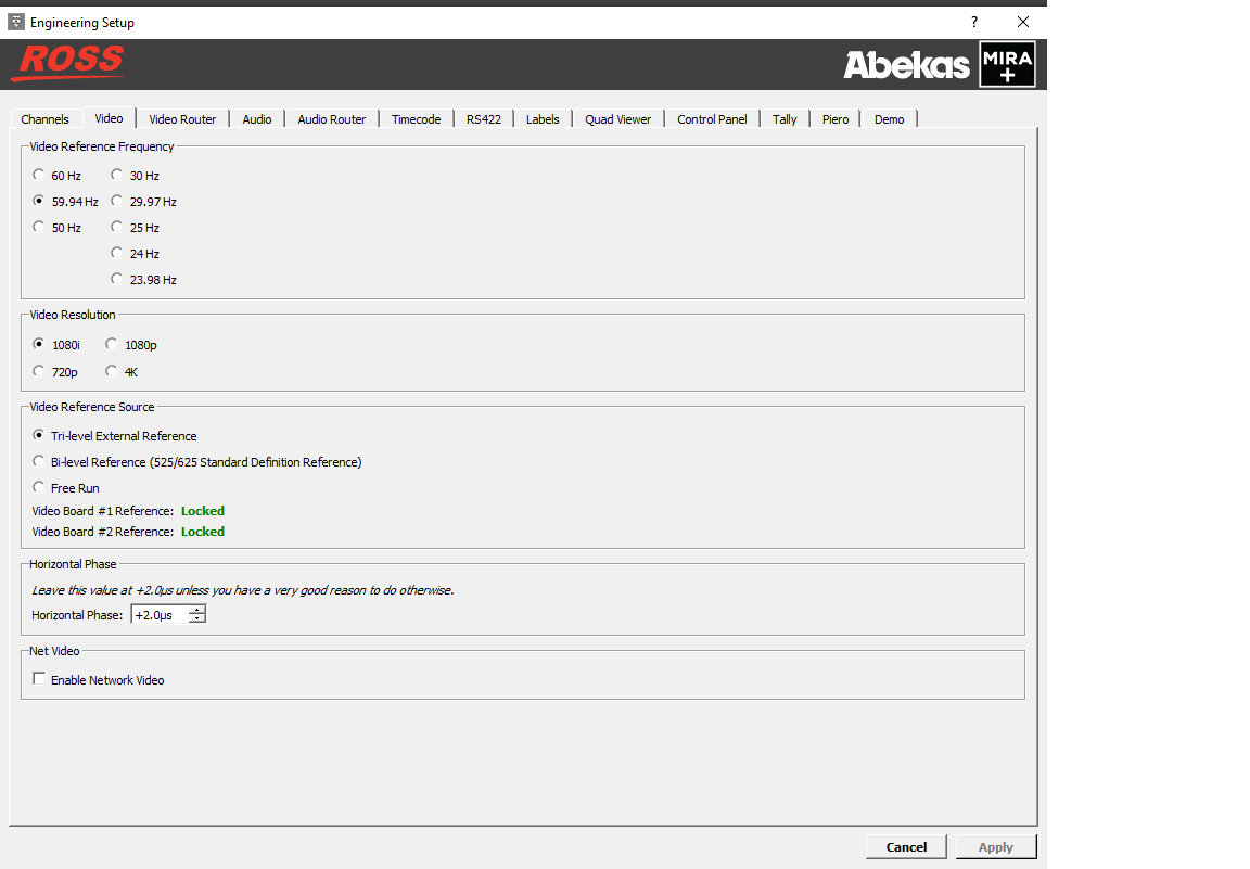

    Attached is a screen shot of the engineering menu of a Mira+ and it has both options of 29.97 & 59.94.  We use ours as both record and playback separately and it has worked for us.  Hope that helps.
