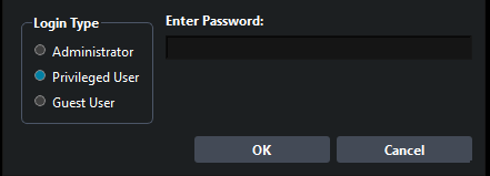

    Hi Greg,
    from your description, it sounds like you are logged in as a guest, without permission to rename, delete, etc.
    Try to close the Mira Explorer app, and run it again.
    on the log-in window , make sure Privileged User or Admin are selected.
    Let us know if it solves the issue.
