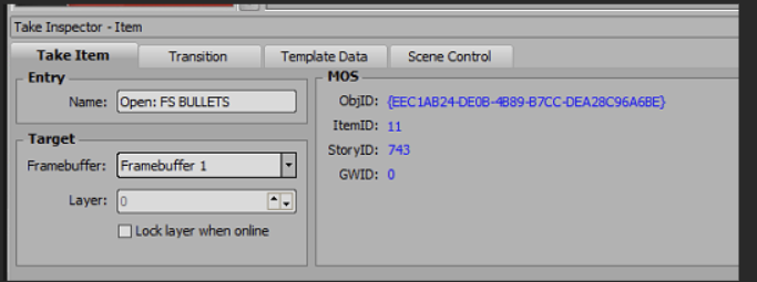

    In XPression you can see the IDs that Mosart will use:
    Sequencer > Select Take Item > Take Item Inspector > Take Item > MOS
    The formatting of the CII read command for a MOS graphic is: X\READ\storyid-itemid-objid\\
    So to trigger the take item above from Mosart the command would look like:
        X\READ\743-11-{EEC1AB24-DE0B-4B89-B7CC-DEA28C96A6BE}\\
    Here is an example of the MOS take item, it's IDs and the CII command that successfully triggers it:
