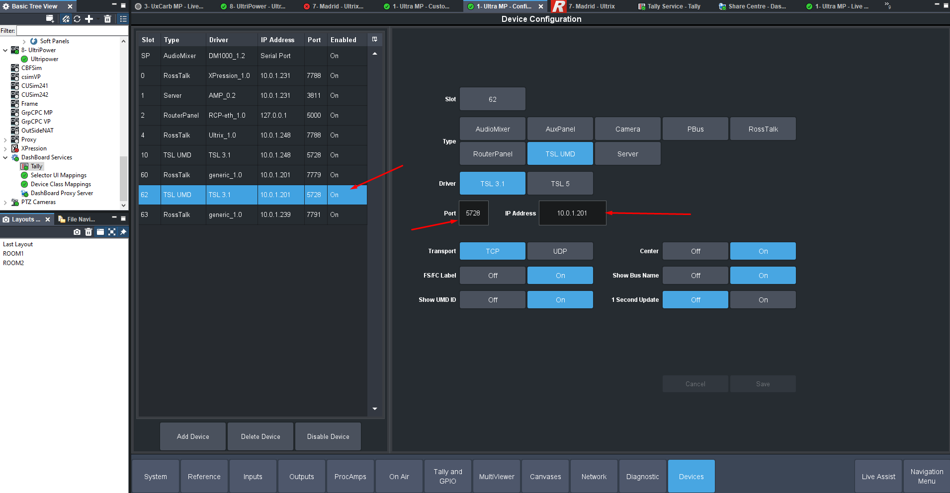

No you would want to set it up on the TRIA computer .. the purpose is to make sure that Data is getting through to it at all
Sent: 11-28-2023 15:59
From: Jason Kaplan
Subject: No Tally to Tria after 7.1 update to Carbonite.
Would the IP address for the device be the IP address of my Touchdrive panel/dashboard computer? I currently have a blank Dashboard Tally panel.

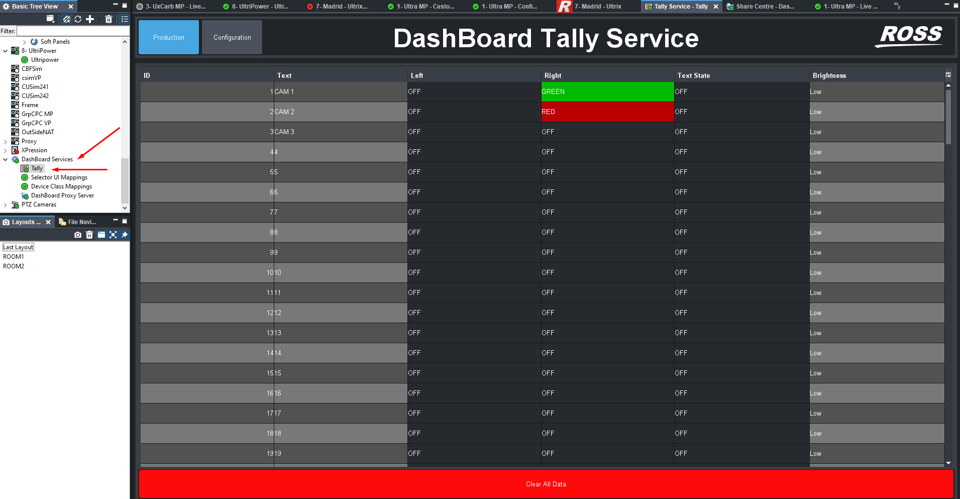

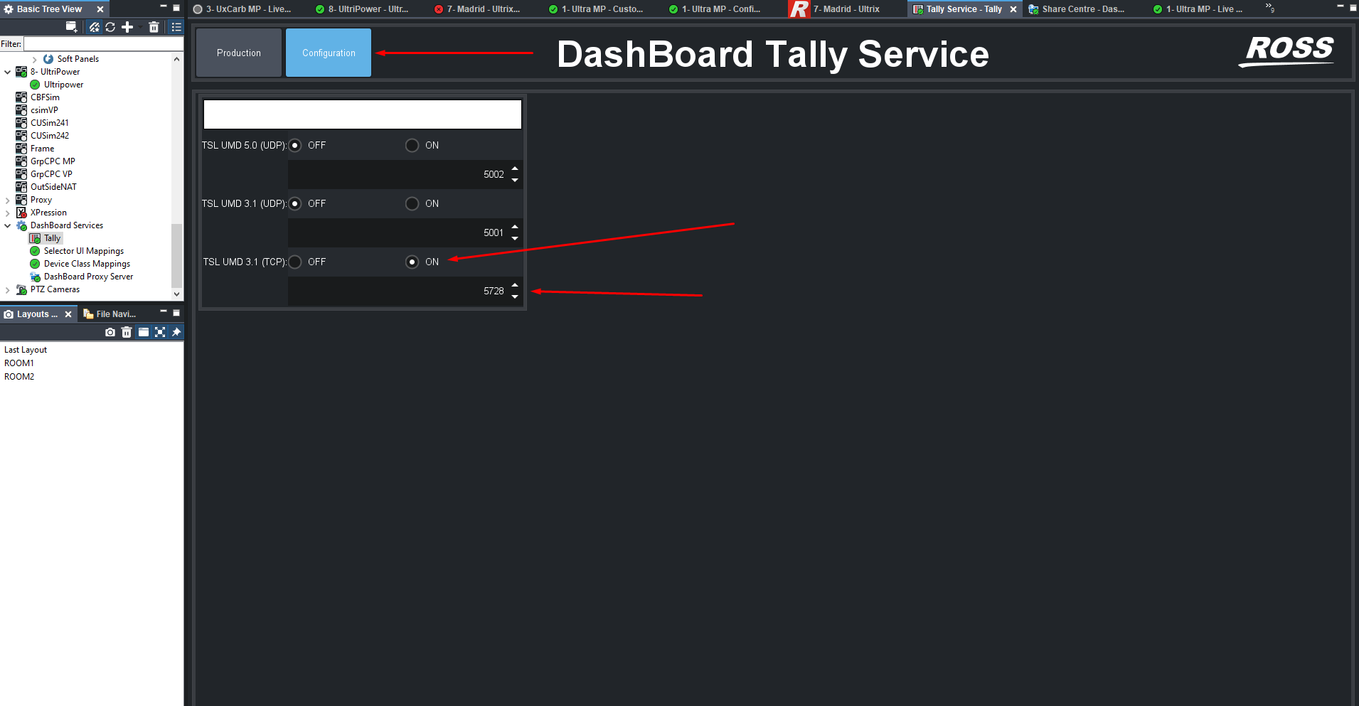

Can you give it a try using DashBoard Tally panel on your Tria?
You can setup the Port so that you send to say 5728 like I am doing with My ultra on Version 7.1.6
you can still have the device setup to send to the Tria on 5727 and then make a second one that sends on 5728 and setup the Tally service in DashBoard to use it to see if your getting data from the switcher to it.
