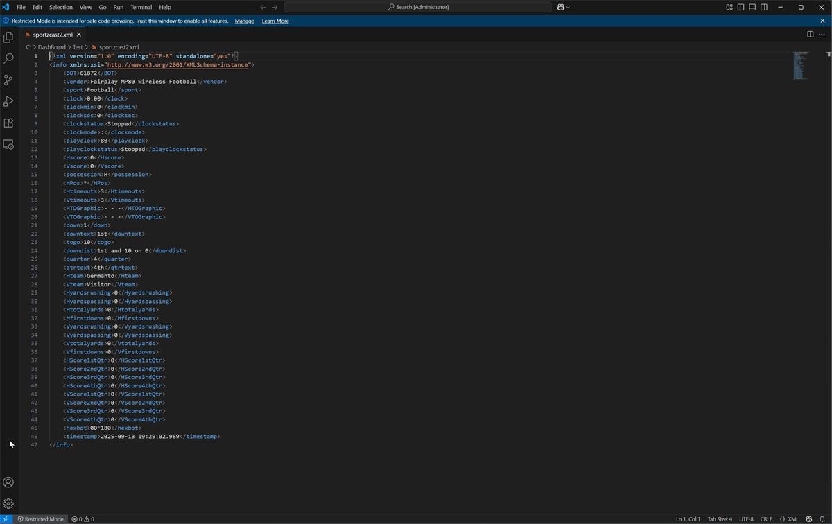

    Can someone help me with the ogScript for displaying the "Hscore" value from this XML file on Dashboard as a label? It would need to update when the value changes.
    I have attempted to make a task using visual logic just to get the something to show up but it is not working. I am a beginner when it comes to scripting.

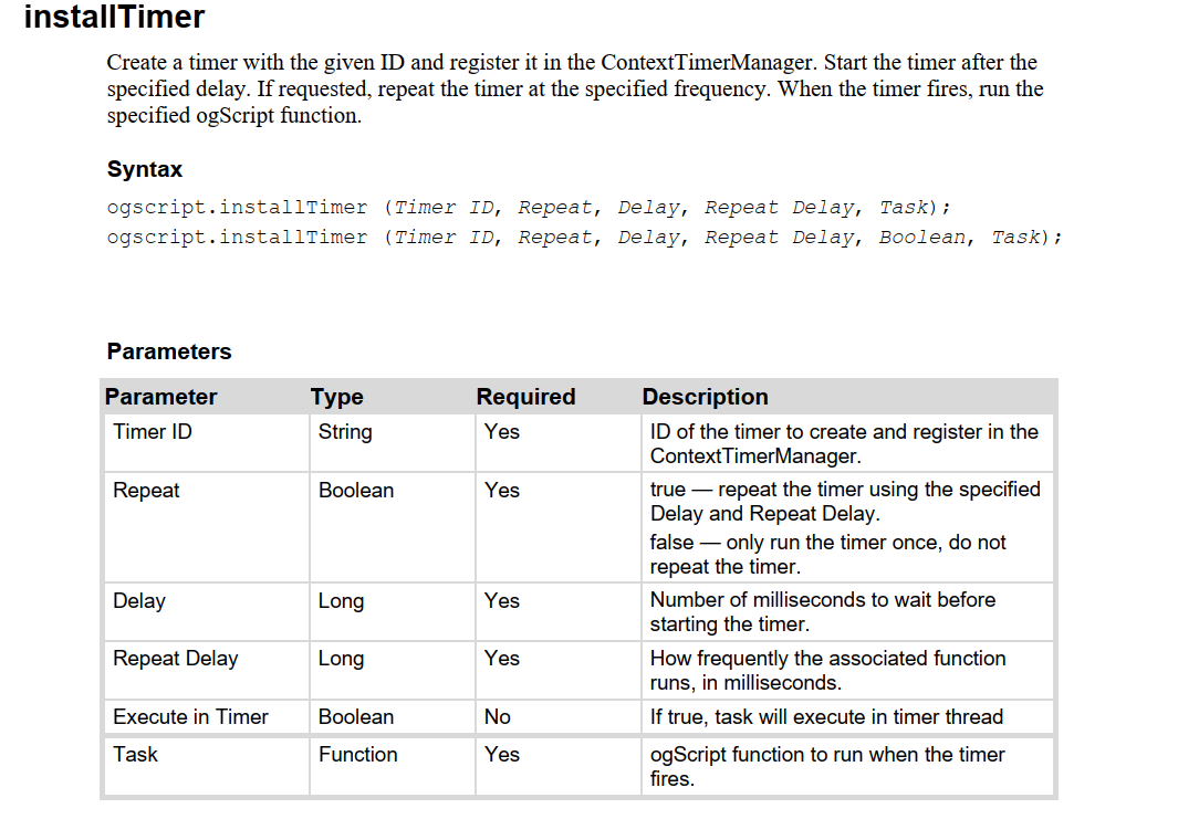

  • 4.  RE: ogScript for displaying XML value in Dashboard
    Posted 09-16-2025 14:47
    Hi Bob,
    Given you already have a function, you can use ogscript.installTimer to register a timer and run a task (your function) in a timed interval.
    Cheers,
    Aury Rukazana
    Senior Software Developer
