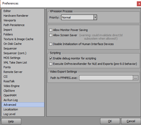

If you are uninstalling/installing a lot on the same system make sure the last thing you do is install. If you uninstall one edition of XPression it will uninstall the script engine for all.
You could also try clearing the script cache: Edit > Preferences > On DIsk Cache > Script Engine > Delete the contents of this folder

I checked with 64bit version, seems to work for me.
You should check the debugger
You can add your own messages as well.
Engine.debugmessage("Hello World", 0)
