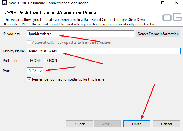

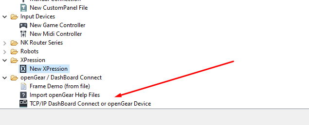

You don't use the "detect information" just ADD the device
Next you enter the data and just hit Finish dont use Detect info...
5253 for just the Main Panel UI or use 5257 if you would like to have the Virtual Panel Surface and menu
