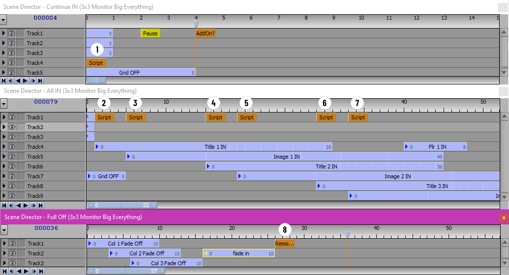

Here's how to use it.
1) Have one material with the desired video and attach it to the objects you want to see the video on. This allows for you to do design without duplicate materials.
2) Your "IN" scenes will need to then have a script that duplicates the video material. Your first object will keep the video material which is duplicated onto the other objects.
3) Add scripts that play video based on object names.
4) "OUT" scenes destroy the duplicated materials. This is most important during the design process because otherwise you end up with lots of new materials you need to manually delete.
Here is an example of an IN scene that goes to the animation scene. Then the OUT scene.
Script 1 in the IN scene is the following:
CopyVideoMaterial(Engine,Scene,"TopGlass 1","TopGlass 2")
CopyVideoMaterial(Engine,Scene,"TallGlass 1","TallGlass 2")
CopyVideoMaterial(Engine,Scene,"TopGlass 1","TopGlass 3")
CopyVideoMaterial(Engine,Scene,"TallGlass 1","TallGlass 3")
Scripts 2 thru 7 are something like this:
PlayVideoRange(Scene , "TopGlass 1" , 0, 30)
Script 8 in the OFF scene is this:
RemoveMaterial(Engine,Scene,"TopGlass 2")
RemoveMaterial(Engine,Scene,"TallGlass 2")
RemoveMaterial(Engine,Scene,"TopGlass 3")
RemoveMaterial(Engine,Scene,"TallGlass 3")
I don't know if it will work for you. It works for me in the design and preview process but fails in Studio.

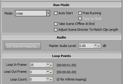

I have one material with a video which have in animation and than loop. So I set it to loop, autoStart off and loop from frame 25.
The question is:
I have lets say 5 quad objects with this material on them and I want each quad to "play" lets say on frame 0, frame 20, frame 40 etc.
How I can do that? Doesn't matter script or VL...
