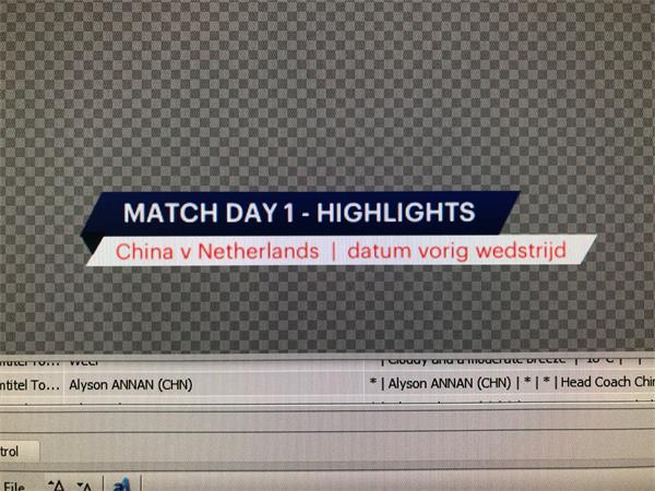

    I've noticed since XP10 the output on the internal Preview window is sometimes (a lot) different than the one on the hardware preview output.
    Is there something I can do to make the hardware output equal to the internal view?
    Above the view from the internal Preview
    And this how it looks from the hardware Preview
    As you can see, I'm missing some rather important information on the hardware output.

    Just to update anyone who is reading this thread - the issue turned out to be caused by the visual logic in the template. Rearranging the visual logic into multiple tabs (which sets the order that visual logic runs in) resolved the previewing issue.
