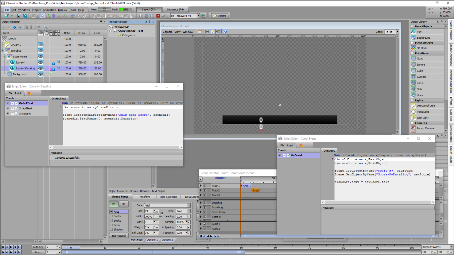

    Hey guys,
    So I am looking for a way to push text from a textobject to an onair item. Let's say I have something like a technical problem screen and I want to be able to update the text with a quick animation without hotswapping to a different take item. So I managed to do it with the help of a script and a bit of a workaround, but I noticed that the trigger always needs to be the actual textobject that changes in order for script to actually update the textobject. With the help of this screenshot I managed to get the text to update if I use something like a list widget and I change to a different object there, but when I was trying to use another textobject with a counter widget to trigger the update. The scenedirector would run, but the script wouldn't execute or update the text.
    Does anybody have any ideas on how that could be fixed?
    Best wishes,
    Johannes

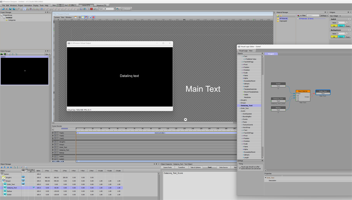

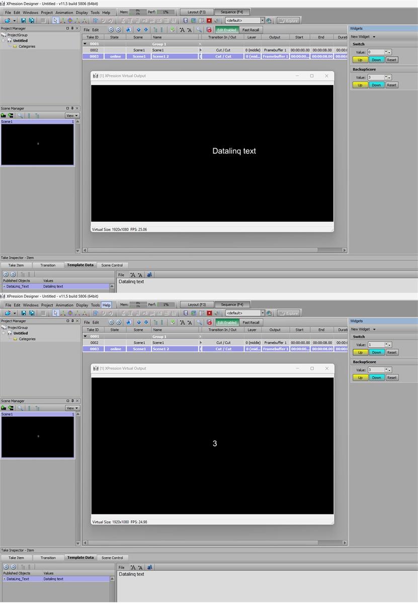

    Johannes,
    I hope I understand what you are trying to achieve. But as I see it, you only want to change the score from a Datalinq score to a manual score (or backup score). In that case, I think you could solve it with two widgets. See the attached screenshots.
    Widget 1 is your switch
    Widget 2 is your backup score (data)
    hope this will work for you. And if it has to animate the switch could also trigger a scenedirector.
    Robert Simons
    XPression Artist
    NEP GFX
    Hilversum Netherlands
  • 3.  RE: Push to air button
    Posted 06-05-2026 14:52
      |   view attached
    Hi Simon,
    the problem actually shifted in the meantime.
    So I managed to have score changes with a counterwidget play an scenedirector first and then update the "old" score to the current score at the end of the scenedirector. But now I want to add a condition to the script that checks if the score is getting bigger or smaller and then plays either the score up or down scenedirectors.
    I put the current setup I use in the attached files. There you can see the animation working but only up and not down. I already managed to have a second scenedirector with the other animation but I'm missing the "onsettext" script to check if the number got bigger or smaller.
    The original post came from a similar position where I wanted to push text from the original textbox to a onair textobject without the need of a datalinq or a secondary textfield that the gets animated into. So basically a datalinq but without external data. So I want to use the "onsettext" script to update onair text without external data but with the same textfield. So to paint a picture. I have a lower third with the text "technical problem" after a minute I might know what the issue is and I would want to update the text in said lower third. But I would like to avoid a second takeitem with a back2back setup and use the original textbox of the original takeitem and just push this new text to the already onair item.
    Sorry for this cluster of issues and thoughts.
    Best wishes,
    Johannes
    Attachment(s)
    xpf
    ScoreSwapAnimation.xpf   38 KB 1 version
