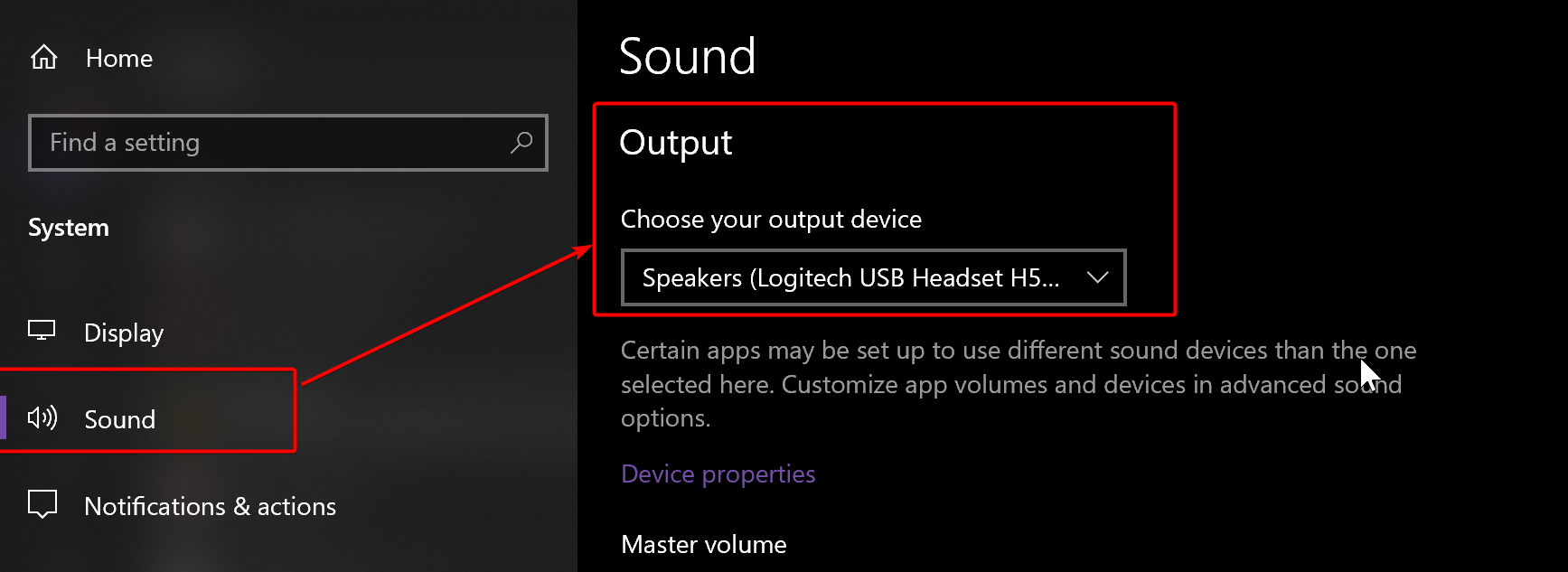

    I assume you must be trying to add an audio device into the audio device list in XPression Hardware Setup?
    XPression > Edit > Hardware Setup > Audio Device > Add
    Does your audio device appear in the Windows Audio Output Device list?
    XPression can only pick up audio devices that are properly installed and avaiable in Windows.
    The audio device must also be installed and available BEFORE opening XPression.
    Ex. a USB audio device must be connected and working in Windows before you open XPression, for XPression to detect it.
    What is your audio device? How does it connect to Windows? Is it using a Motherboard/Sound card device/input? Or is it a USB audio device? Does it need Windows drivers installed to work?

    Thank you.
    Thanks to you, I've solved the problem!
