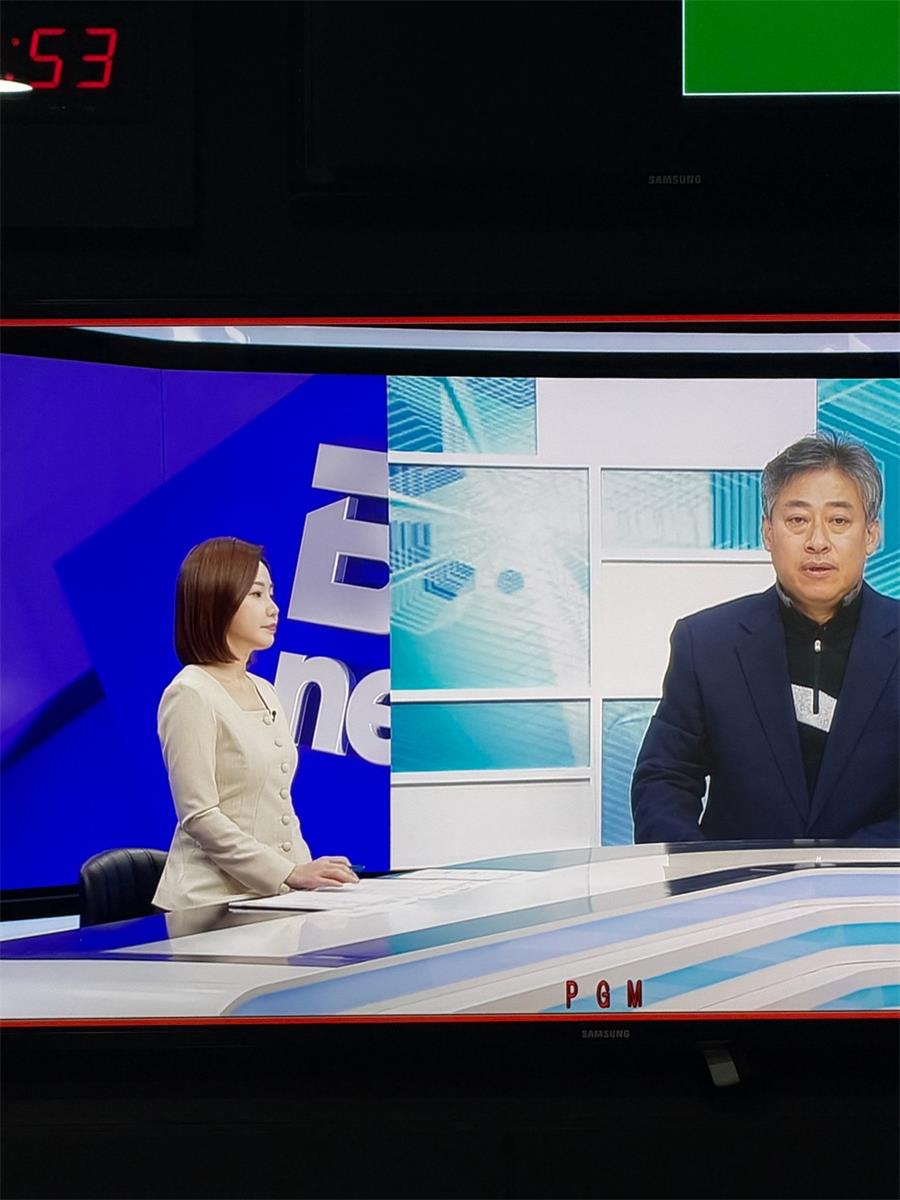

    When I created a DVE Box with key on the Carbonite Ultra/Ultrix Carbonite equipment, I have a few questions to ask.
    If you look at the picture below, the image of the man on the right is a video uploaded as a key.
    The boundaries of this DVE Box are so clear that I want to make the bounding edge a little smoother.
    For example, I want to make it feel like a gradient effect.
    I want to make it feel like it's smoothly connected without creating boundaries with the PGM screen in the back, is this possible with the Edge Softness function?
    I'd appreciate it if you could give me some advice

    Hi Mr Han,
    Yes, you are correct. You can use Edge Softness to feather the edges of the DVE Box. It will result in a soft gradient between the DVE Box and the Background.
