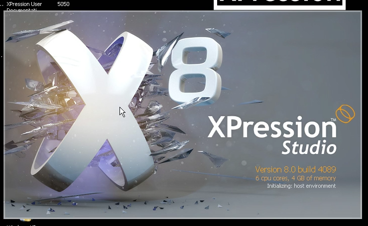

64bit XPression was released in XPression version 9, so if you are not entitled to v9 because of software maintenance expiry, you would likely only need to purchase 1yr of software maintenance.
That said, Gerard is correct, more RAM/memory is rarely a solution. For example, if you are having issues with output stuttering/video playback, that will not be solved by increasing RAM/memory.

Hello, i have a ross xpresion and i have alocated only 4g of ramm, in pc i have now 16G.
How can i alocate more?
