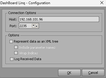

Here is the setup in Datalinq Server, which is running locally on the XPression Studio. The Dashboard is running on another machine on the same VLAN/subnet and streaming on port 2235.

Sent: 03-03-2026 11:48
From: Simon Redmile
Subject: Random Freezing on Dashboard Datalinq source
Sorry I meant your datalinq contection to dashboard in datalinq server.

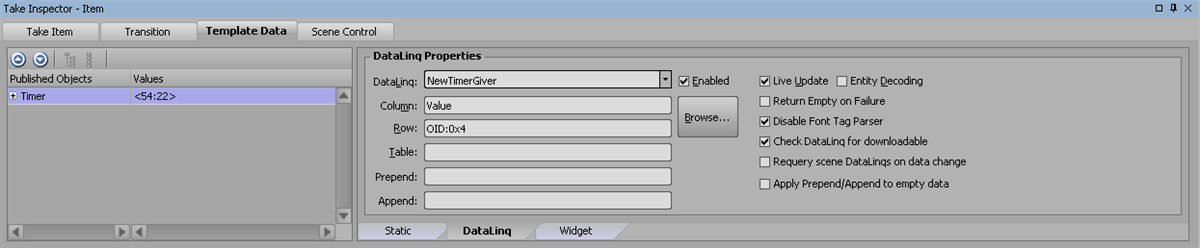

Sent: 03-03-2026 10:59
From: Ryan McCarthy
Here are the Datalinq settings on the published text field. When it freezes, I can hit browse and see live data while the data on air is frozen.

Sent: 03-03-2026 10:54
From: Simon Redmile
what are your datalinq settings?
