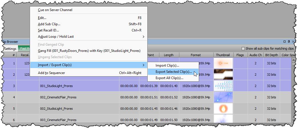

    you're gonna love some of the new features coming in XPression 12.5 in a few weeks. users will be able to select clips in their Clip Browser and Export selected clips into a single file, which can then be brought over to another XPression system and Imported to the clip browser on that system. This will simplify the workflow quite a bit. Same Dialog is used to IMPORT the file on the recieving end.
    XPression Clips Export Clips Contextual Menu Screen Grab
