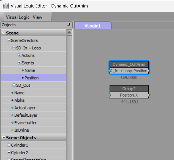

      |   view attached
    Ben,
    I think that using the current Scenedir position, as a first keyframe, won't help you because that keyframe information will be updated every frame (your loop is still running). You can find the current Scenedir position and other values in the logic tab. See image.

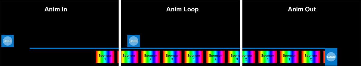

    If I understand you correctly, you want to animate a loop animation offline on a random moment in time.
    How to approach best depends a bit on your Show design I guess.
    I have attached an simple example Scene (Dynamic_Out.zip) consisting:
    • A SceneDir, containing the in animation and loop (using a scene trigger for the loop)
    • And a SceneDir, containing the out animation (using a mask object)
    This entire setup can simply be played from the Sequencer and contains no scripts or logic.
    just use Import, to add  the scene attached, to you project.
    Hope this helps You to find the right solution for this challenge.
