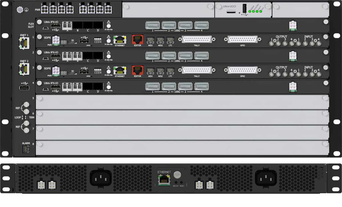

    Wanted to know regarding ip flows in and out to this frame , suppose i am using ST2110 -20 and ST2110 -30  flows in this configuration using a resolution of 1920x1080 50i. how many flows i can use it as an input and output. as showed in calculator it is 48x48. kindly confirm the same if i am not wrong. i am willing to build full ip based workflow.

    Correct each I/O blade is going to give you 16x16 with -7 redundancy.
    So with 3 Blades you will have an effective IP IO of 48x48.
