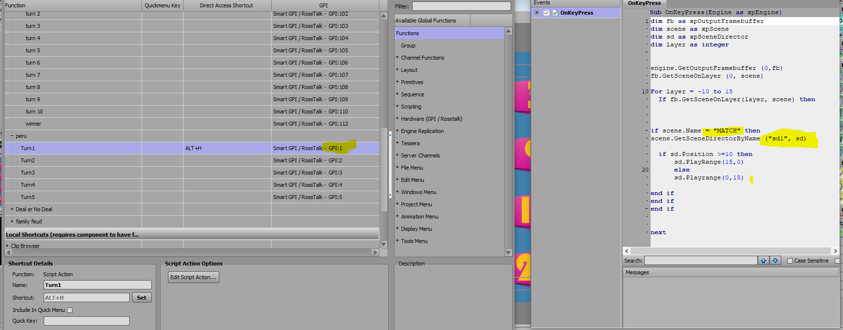

      |   view attached
    I have partially built the game for you. I have included screen grabs to show you how to do the gpi triggers. The script for each flip MUST be edited to change the name of the sceneDirector to the correct name. The dashboard has all 24 gpi triggers set up so you don't really have to dig in there but go for it. GPI triggers are 1-24.
    Malcolm Thorpe
