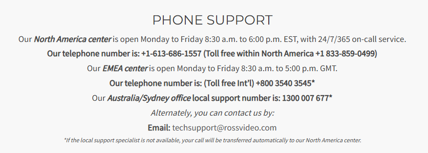

    Once you have an idea if it is related to the hardware or if there is some how a software bug related to the controls you are trying to use and that knob then you would want to contact support to trouble shoot it further and open a ticket:
    you can open a ticket online above or also contact support:
