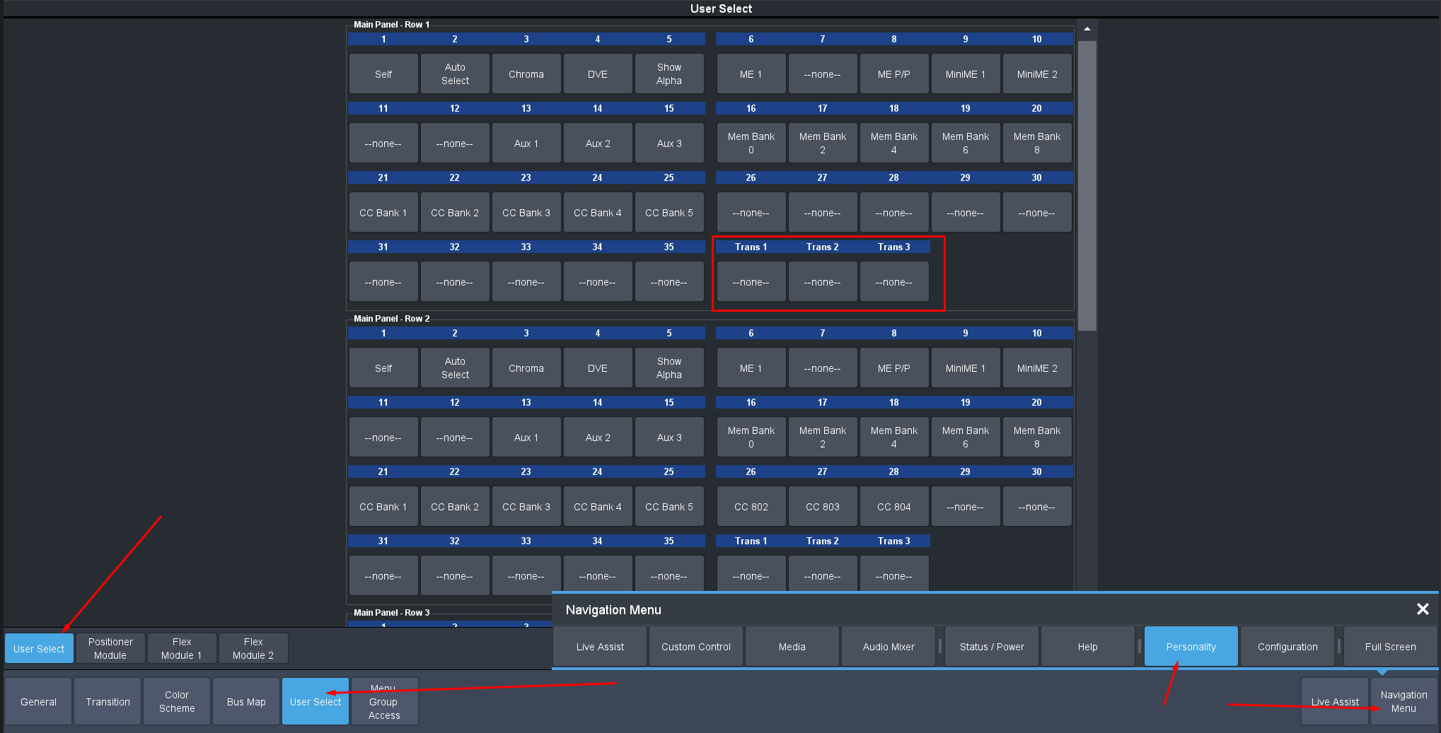

    Does anyone know how to customize the buttons on Ross Touchdrive that say "Trans 1" "Trans 2" and "Trans 3?" I have looked everywhere, and haven't been able to find anything. The "transition" section of the manual even says, "The TRANS X buttons are configurable and can be assigned different functions," but it doesn't tell you how to actually configure them. The goal is to put custom transitions on those buttons.

    In the Personality Menu under User Select Buttons.  Each Row is assignable
