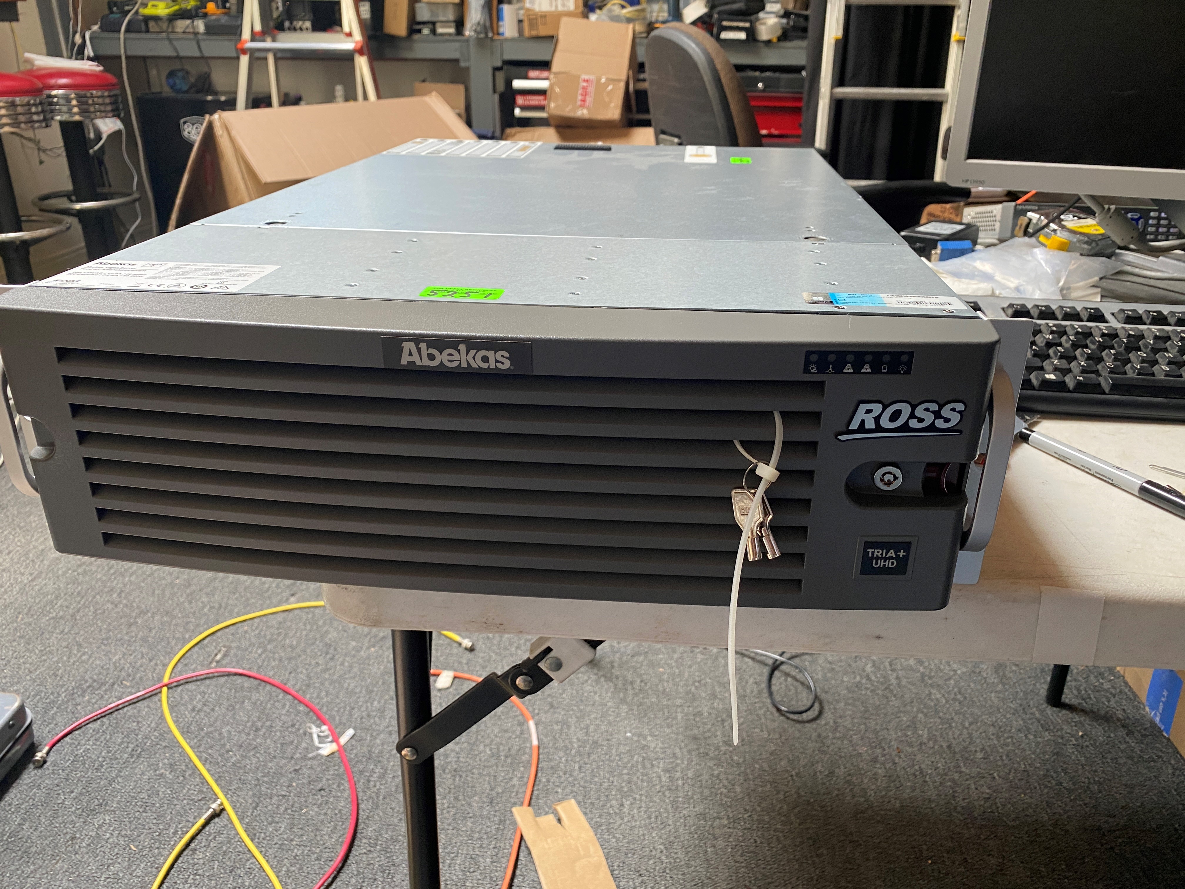

    Ross Abekas Tria+ UHD 4K Video Production Server front

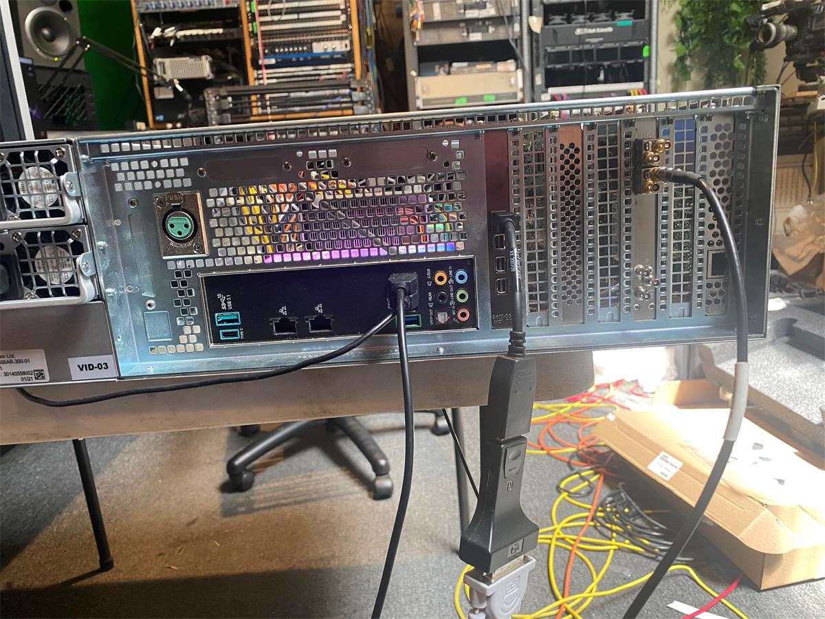

    Ross Abekas Tria+ UHD 4K Video Production Server -REAR

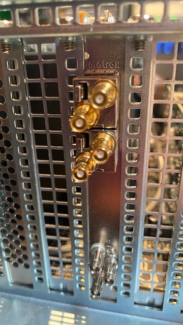

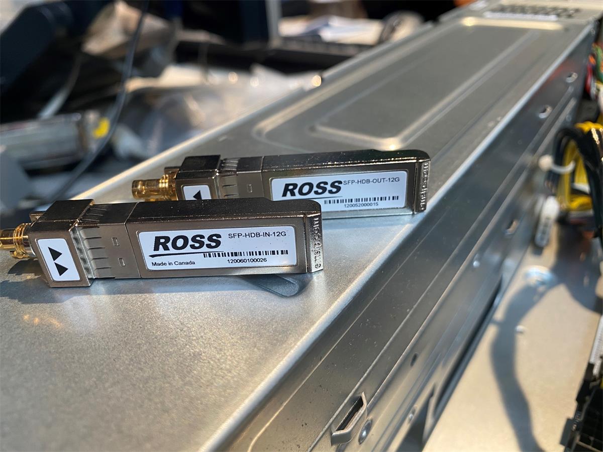

    Only (1) Existing Input-Output card with SFPs
    SFPs in rear BNC play-record card
    ndering if anyone is using the Ross Abekas Tria+ UHD 4K Video Production Server, and knows maximum channels it can support,
    in either 4K or 3G ?  It currently has (1) play Record card with rear BNCs and SFPs
    IF it cannot be upgraded to handle more 4K channels, we will sell it and look for different model.

    Hi Matthew, Tria+UHD is limited to two UHD channels.
    In UHD, It can ingest XAVC-I at either Class 300 or Class 480.
    It can also ingest 1080p, At XAVC-I class 100, also limited to two channels.
    Unfortunately there is no option to upgrade the channel count.
    There are other Ross products, like new Media I/O models that can support up to 4 UHD channels, and also support other codecs such as ProRes and DNxHD/HR.
