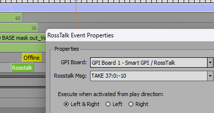

    This Rosstalk event in my scene director timeline will not fire the take item in my sequencer. Anyone know what I'm missing here? I have my RossTalk/Smart GPI setup correctly in the hardware panel. GPI and RossTalk are working fine in other parts of my project.

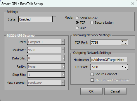

    You need to make sure you have outgoing as well as in coming to use them from the Scene Director.

    Thanks, Simon. Can you elaborate on "outgoing as well as in coming" please? I'm not following you.

    Boom!. Thanks, Red.
