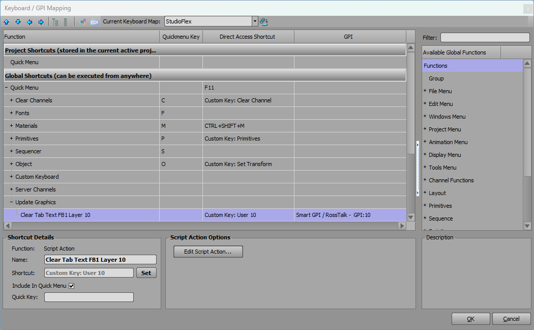

    You might be able to use a GPI trigger to run a script, however, to update the text after you play the graphic online. It sounds like you're looking to clear a specific field (i.e., "TAB TEXT" or "LINE 2") and the graphic is on a consistent framebuffer or layer.
    Add a Keyboard/GPI Map Script Action to your XPression engine like this:
    dim fb as xpOutputFrameBuffer
    dim scene as xpScene
    dim text as xpTextObject
    engine.GetOutputFrameBuffer(0,fb)
    fb.GetSceneOnLayer(10,scene)
    scene.GetObjectByName("TAB TEXT",text)
    text.Text = ""
    In this case, we'd be looking to clear the "TAB TEXT" field on a graphic online in Framebuffer 1 (Index Value "0") on Layer 10. Replace any of those values with those of your graphic. The graphic would update on-air without having to retrigger the item in Overdrive.
    The script could be triggered by a keyboard shortcut directly on the XPression Engine, or a GPI Trigger sent via RossTalk from another device.
