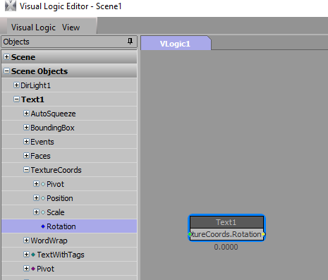

Hi Red, I ran into this issue not long ago. Your method does work, but I was thinking how much simpler it would be if this feature was added to Continuous Animations. Currently there are only Texture Pos X and Texture Pos Y options available. Can Texture Rotation be added as an option to Continuous Animations in future updates?
I'm using XPression 10.5 build 5508

You can rotate the texture cords on the object itself
eg here I have a quad position to the rotation of the text

Hi.
I am trying to figure out how to rotate the face texture on a font I created. The texture is just a png. I am trying to figure it out in Visual Logic, but I am new to VL. Any insight into how to get this to work would be fantastic!
