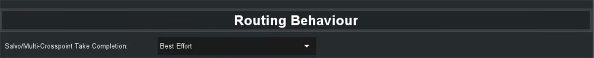

Hi Mike, thans for this. We are on 6.5.
Where is this menu please?

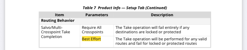

Hi Jeremy
Thanks for the question
Yes, however you may need to contact support to get an upgrade file if you are not already running your Ultrix on version 6
there is now a "best effort" setting for salvos
