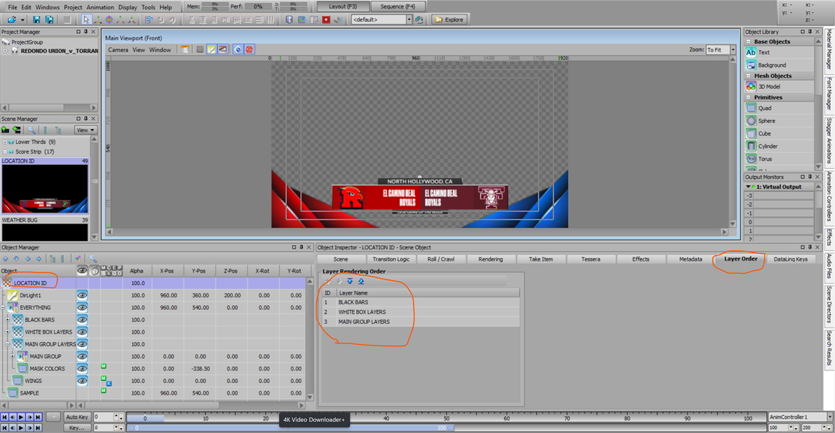

  • 5.  RE: Scene not playing back properly.
    Posted 11-26-2025 03:57
    I know you fixed it, but did you try the Layer Order? On my scene, I had multiple scene directors and Layer groups, and this is how I fixed it when it wasn't displaying correctly.
    Just a thought =)
