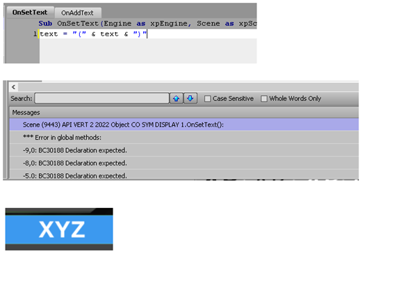

Sadly I don't recognize this error I wrote this.
text = "(" & text & ")"
it was compiled right away.
I see you have global method errors there as well, what are you using there?
Sent: 05-26-2022 10:48
From: Mark Stasiowski
Subject: Script question
So I added a new text field, re-typed the script and I'm getting the same errors. Any thoughts?
Sent: 5/26/2022 9:46:00 AM
From: Red
Subject: RE: Script question
Your script looks fine, it's not the best answer I have but perhaps make a new text object, put the same font on it and add the script and see if that fixes it. Delete the broken one.
Sent: 05-26-2022 09:28
I was using a simple script to add parenthesis and percentage signs to text. Now it is not working. Here is the script, errors and text it used to work on.
