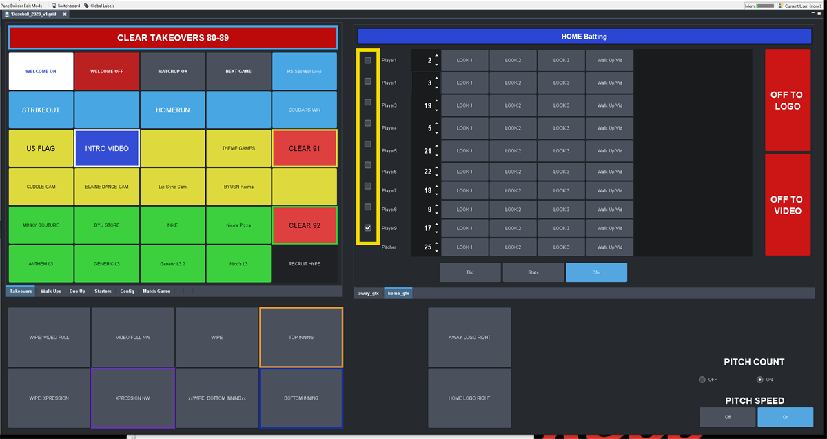

    Posted 02-21-2023 23:13
    Here's the dashboard and a screenshot of the dashboard. The yellow box highlights the checkboxes that I use to indicate current player at bat. This is datalinqed with the "at bat data" in the Xpression scene.
    If I put the script in OnOnline, it will only run an animation when the scene goes from offline to online. I don't know if OnRender is the correct place for my script. It seemed to make sense for a script that should run when the scene is already online. I could be wrong though. I'm still learning scripting.

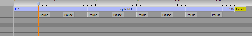

    Hey guys, you were headed in the right direction, this is what I do for the same thing.
    I have one scene director that moves all the highlights and then my script looks simply like this.
    This goes on text object linked to an integer coming from my dashboard onSetText

    My scene director looks like this
    Ignore the pauses they are just for testing that track is turned off now.
    The last event is for playing 1 to 9.
    That's why you'll see that if = 1 is slightly different.

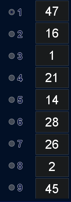

    Posted 02-22-2023 13:12
    In my dashboard it makes an integer value 1 through 9
    Visually it looks like this;
    In the XPression scene the value of that integer is in a textbox with liveupdate checked.
    This text object has the onsettext script I shared earlier.

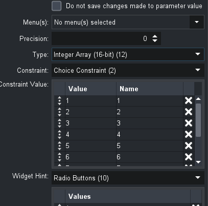

    Posted 02-22-2023 14:13
    I can't share this one as I am building it for a client.
    All it is is an integer Array parameter that I have chosen to display as radio buttons.
    I then drew a simple grid and forced it to 1 column width.
    Chose my parameter and placed it in the grid.
    I have moved just the parameter and display object to a separate panel for you to look at though.
