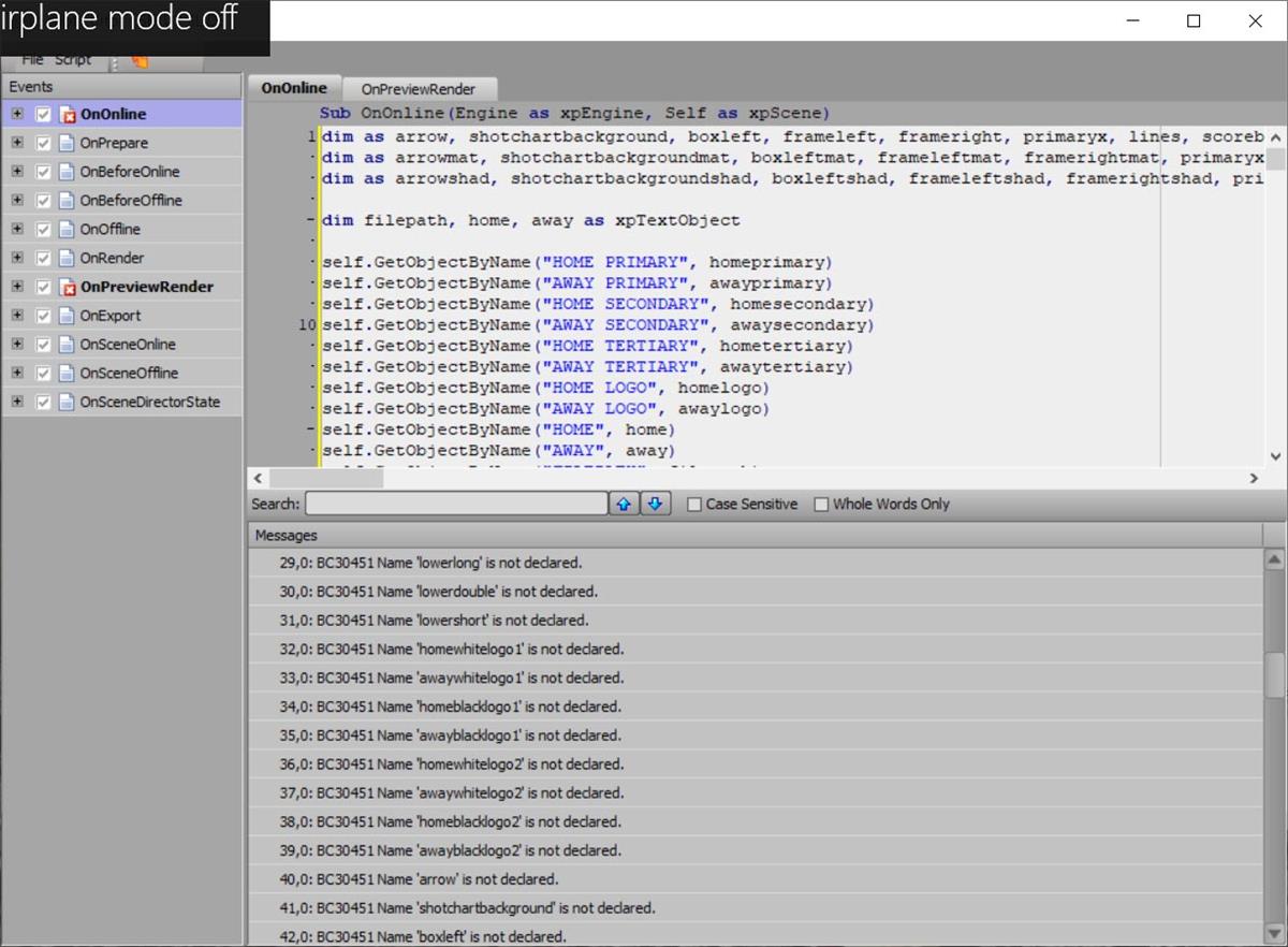

    Hi ERICR.
    You don't have 'Dim..as' in the script.
    Dim arrow, shotchartbackground, boxlef, boxleft, frameleft As xpBaseObject
    Dim arrowmat, shotchartbackgroundmat, boxleftmat, frameleftmat As xpMaterial
    Dim arrowshad, shotchartbackgroundshad, boxleftshad, frameleftshad, lowershortshad As xpBaseShader
    Dim filepath, home, away As xpTextObject

  • 3.  RE: Scripting
    Posted 05-15-2023 11:43
    I have Dim at the front and as at the end of the line. If I add it to the front after the Dim or change the A to a capital letter I get all these errors.
    Isn't the line normally written like this....
    Dim something, something, as xpBaseObject
    Dim something, something, as xpMaterial
    Dim something, something, as xpBaseShader

  • 4.  RE: Scripting
    Posted 05-15-2023 12:13
    Yes, it's quite normal. The only thing is that you don't need a comma after the last variable.

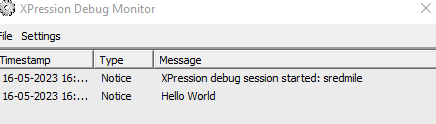

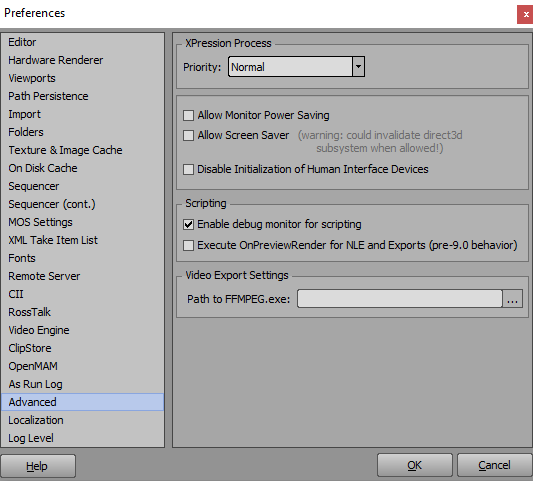

    My apologies if you know the stuff below but its how I usually find my problems in my scripts.
    Compiled doesn't necessarily mean your script is correct, it just means there aren't any syntax errors.
    You should try putting some debug messages in your scripts to see where the script is getting to and breaking.
    You can put messages like this;
    engine.DebugMessage("Hello World", 0)
    throughout the script to see where the script is getting stuck.
    I would put one at the beginning and end to start with and then move that end point up through the script until you see it post in the debug log.
    Once messages are written to the debugger you'll see it appear in the sys tray.

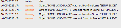

  • 20.  RE: Scripting
    Posted 05-16-2023 12:03
    I have a debug messsage start and end.
    This is my debugger.
    it's getting stuck where it cannot find these objects.
  • 21.  RE: Scripting
    Posted 05-16-2023 12:18
    So the issues I found were stopping your script were, BLACK, WHITE and REFLECT.
    Commenting those out meant the script gets to the end.
