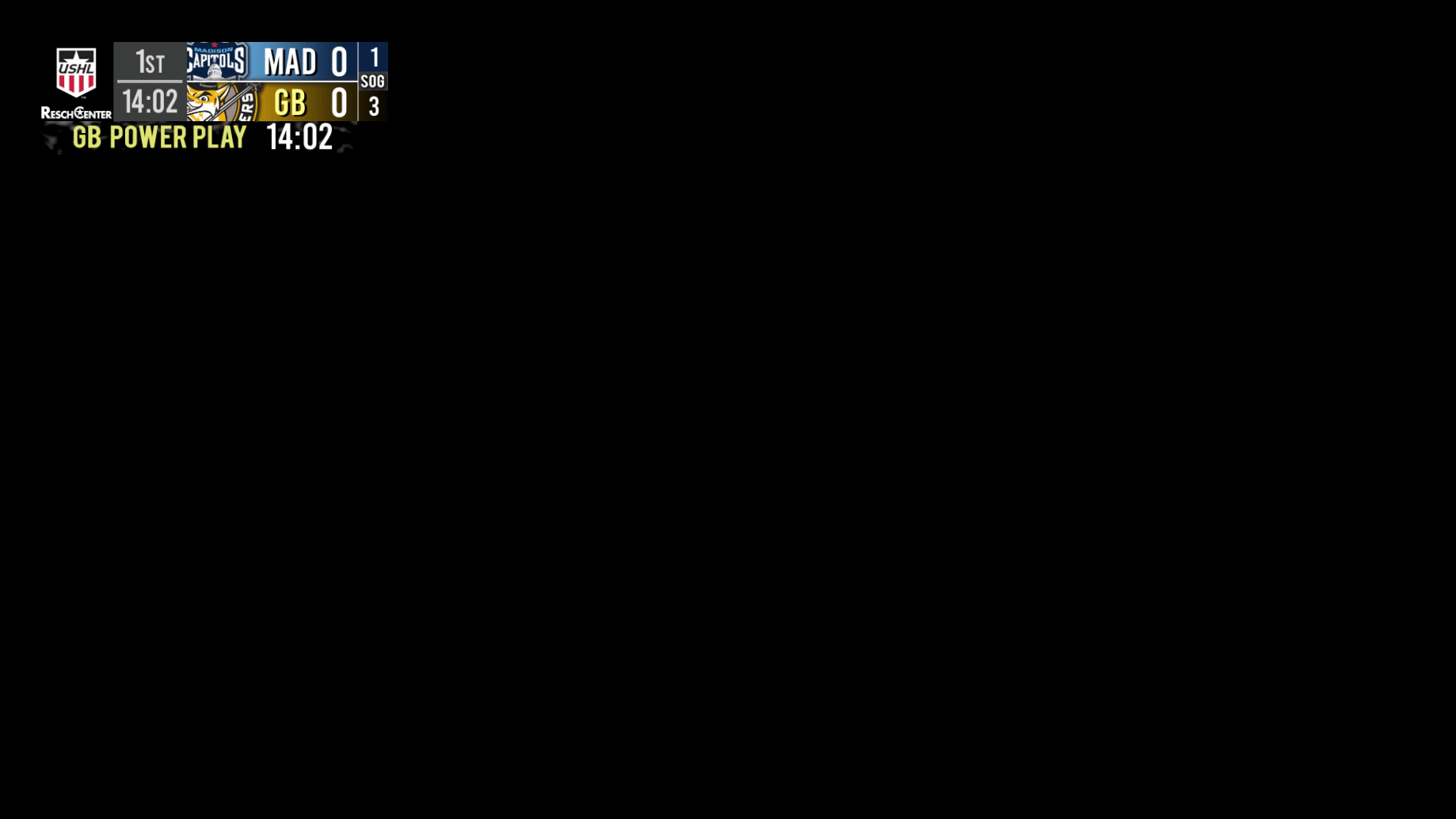

    Here is my script below. The issue I have is everytime the timer changes, the script fire off again causing a loop like you see in the video. My current script is this:
    dim sd as xpSceneDirector
    dim si as xpSceneDirector
    scene.GetSceneDirectorByName("IN", sd)
    if text >= "0:01" then
    sd.PlayDirection = PlayDirection.pd_Forward
    sd.continue
    end if
    scene.GetSceneDirectorByName("Out", si)
    if text <= "0:01" then
    si.PlayDirection = PlayDirection.pd_Forward
    si.play
    end if

    with this line "if text >= "0:01" then" to trigger every time the number is greater so it triggers with every number change?
    Would you not just want = there so it plays it the once at 0:01 and never again or have I miss understood what you're trying to achieve.
    Sorry I couldn't really spot anything in the video.
  • 3.  RE: Scripting Wait or Stop
    Posted 05-26-2022 11:43
    Correct. This is OnSetText.
    I swear I did just = before and it did not work, but now it seems to be working. I will keep playing and see if I can break it again.
