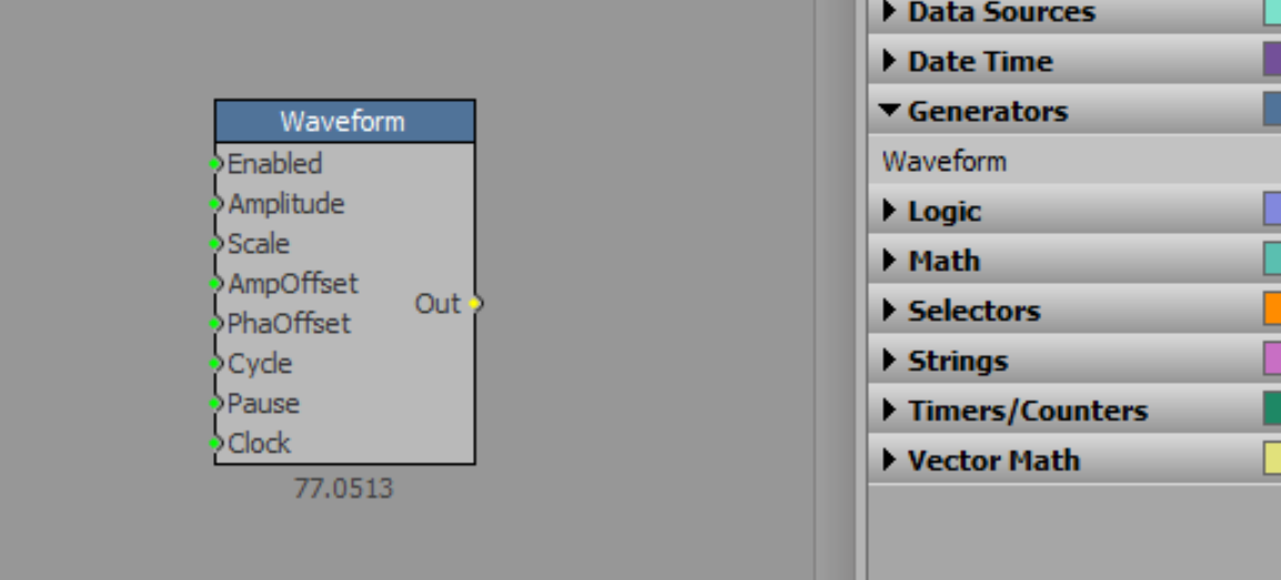

    He means the waveform node.

    Posted 04-14-2026 13:54
    But how do I stop the Waveform from theoretically changing it's value while onair and swapping out the video playing?
    Best wishes,
    Johannes
  • 6.  RE: Select random video
    Posted 04-14-2026 13:58
    It wouldn't be the way I would solve it, I was just saying what I think he meant, that's why I linked my solution after.
