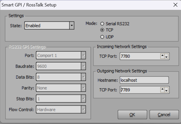

I've sent message over TCP from XPression back to Dashboard, so this would work for you too.
In your hardware setup, do something like the below. If you are running your app on the same machine as XPression make sure your TCP port is different to your incoming network settings port. I've used TCP, but you can use UDP if your app is on the same machine as it's slightly easier to implement.
