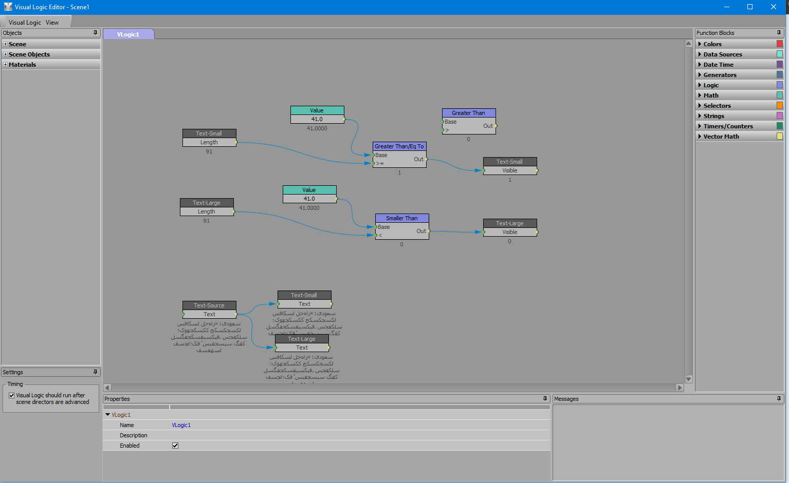

  • 4.  RE: Set Font Size on line index
    Posted 09-23-2025 07:09
      |   view attached
    have done in this way. by VL

  • 5.  RE: Set Font Size on line index
    Posted 09-23-2025 07:11
    Personally I would have used bounding box height, when its double a single line you'll know its gone to 2 lines.
    More reliable than length.

  • 7.  RE: Set Font Size on line index
    Posted 09-23-2025 12:01
    No I mean, bounding box size for getting the line break, not squeeze or wrapping.
    So where you use length you should use boundingbox.height I mean rather than length.
  • 8.  RE: Set Font Size on line index
    Posted 09-24-2025 00:46
    Yes, that was more feasible with bounding control. Cheers!
