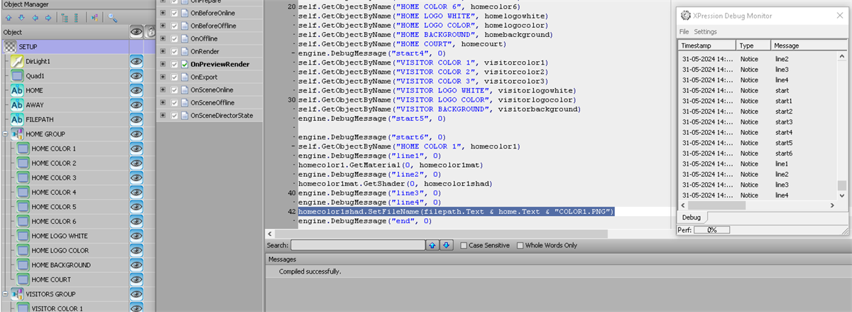

    I'm looking to see if anyone might be able to help me figure out this very simple problem. I've done this a dozen times and today it's not working. I'm trying to map the sharder for homecolor1shad from the filepath.Text. When I use the debug monitor I noticed it stops at the filepath line. I've confirmed the file is in the folder of the path listed. I'm sure I'm missing something every simple.

    engine.DebugMessage("start", 0)
    dim homecolor1, homecolor2, homecolor3, homecolor4, homecolor5, homecolor6, homelogowhite, homelogocolor, homebackground, homecourt, visitorcolor1, visitorcolor2, visitorcolor3, visitorlogowhite, visitorlogocolor, visitorbackground as xpBaseObject
    engine.DebugMessage("start1", 0)
    dim homecolor1mat, homecolor2mat, homecolor3mat, homecolor4mat, homecolor5mat, homecolor6mat, homelogowhitemat, homelogocolormat, homebackgroundmat, homecourtmat, visitorcolor1mat, visitorcolor2mat, visitorcolor3mat, visitorlogowhitemat, visitorlogocolormat, visitorbackgroundmat as xpMaterial
    engine.DebugMessage("start2", 0)
    dim homecolor1shad, homecolor2shad, homecolor3shad, homecolor4shad, homecolor5shad, homecolor6shad, homelogowhiteshad, homelogocolorshad, homebackgroundshad, homecourtshad, visitorcolor1shad, visitorcolor2shad, visitorcolor3shad, visitorlogowhiteshad, visitorlogocolorshad, visitorbackgroundshad as xpBaseShader
    dim filepath, home, away as xpTextObject
    engine.DebugMessage("start3", 0)
    self.GetObjectByName("HOME COLOR 1", homecolor1)
    self.GetObjectByName("HOME COLOR 2", homecolor2)
    self.GetObjectByName("HOME COLOR 3", homecolor3)
    self.GetObjectByName("HOME COLOR 4", homecolor4)
    self.GetObjectByName("HOME COLOR 5", homecolor5)
    self.GetObjectByName("HOME COLOR 6", homecolor6)
    self.GetObjectByName("HOME LOGO WHITE", homelogowhite)
    self.GetObjectByName("HOME LOGO COLOR", homelogocolor)
    self.GetObjectByName("HOME BACKGROUND", homebackground)
    self.GetObjectByName("HOME COURT", homecourt)
    engine.DebugMessage("start4", 0)
    self.GetObjectByName("VISITOR COLOR 1", visitorcolor1)
    self.GetObjectByName("VISITOR COLOR 2", visitorcolor2)
    self.GetObjectByName("VISITOR COLOR 3", visitorcolor3)
    self.GetObjectByName("VISITOR LOGO WHITE", visitorlogowhite)
    self.GetObjectByName("VISITOR LOGO COLOR", visitorlogocolor)
    self.GetObjectByName("VISITOR BACKGROUND", visitorbackground)
    engine.DebugMessage("start5", 0)
    engine.DebugMessage("start6", 0)
    engine.DebugMessage("line1", 0)
    homecolor1.GetMaterial(0, homecolor1mat)
    engine.DebugMessage("line2", 0)
    homecolor1mat.GetShader(0, homecolor1shad)
    engine.DebugMessage("line3", 0)
    engine.DebugMessage("line4", 0)
    homecolor1shad.SetFileName(filepath.Text & home.Text & "COLOR1.PNG")
    engine.DebugMessage("end", 0)

    You don't seem to be getting the text object associated with "home". Or "visitor" or "filepath". You're creating the variables so the compiler is happy, but you're not attaching them to anything.

    Thank you @Jean Russell I knew it was something small I forgot.
