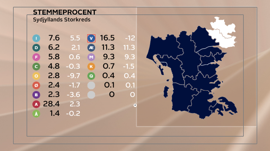

Basicly, what I want, is to readout data from the json link I have.
I get this for each party:
logo - percent - +/- percent
16 partysThese are now all my objects:

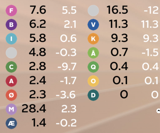

I need to sort the partys, based on the black number and then place them at the right position.
At first, I sortet with visual logic, but i did'nt sort them right.
Therefore I need to sort them another way.
I have tried as you describe, IT works, when I put it on the OnRender in scrpt!
But I also need to move the logo and the +/- with the percent...

OnSetText in script event on the datalinqed text i've did this:
Text = Replace(Text, ".", ",")
It replaces the dot, but the sorting is still not right.
