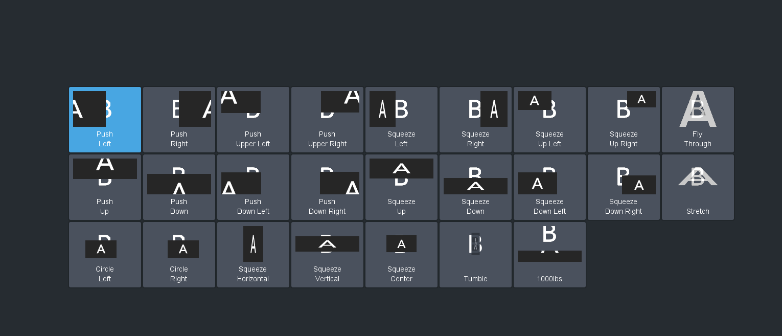

I see 25 options in the CC Menu and in the DVE Live Assist Selection Menu?

Yes, but each wipe doesn't seem to have a command.

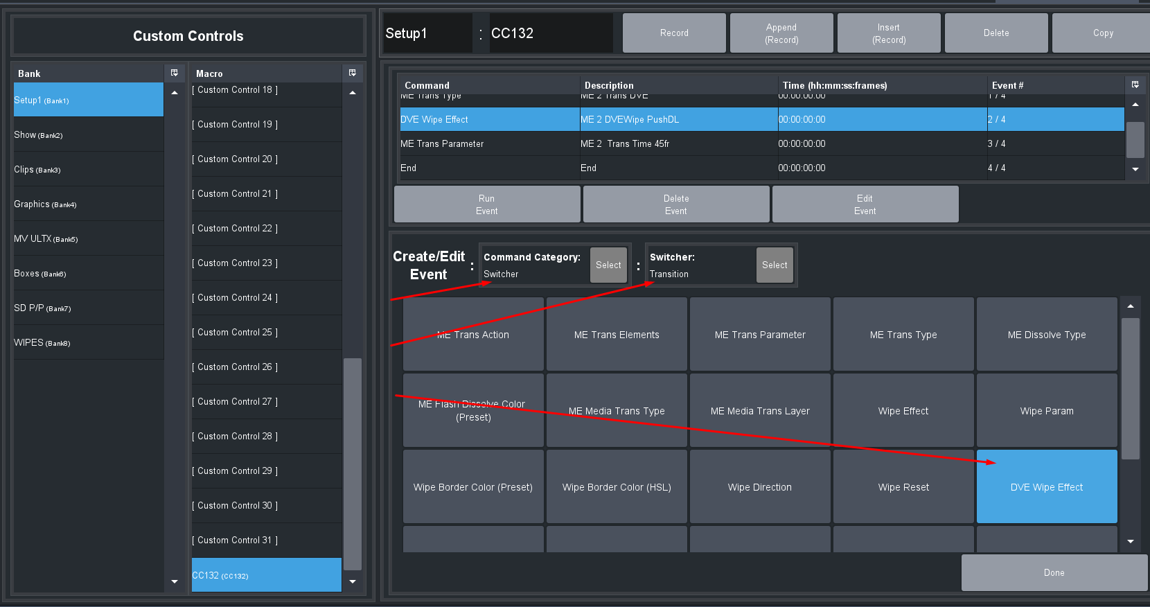

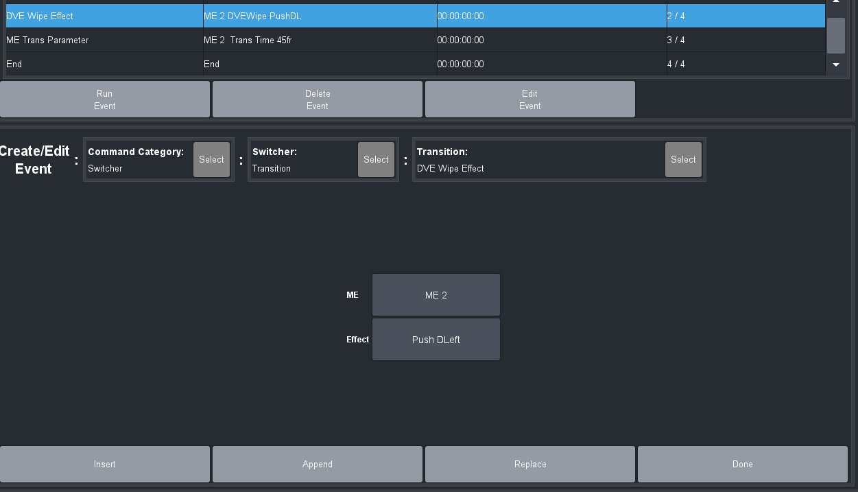

It does have a specific command for this.
Under Switcher - Transition - DVE Wipe Effect

Ah! The "watch me" Record mode. Of course! The way to have CC do everything you want even when there is not a specific command for it. I'll remember that for other things I'm sure I'll want to do.

Hi Danny,
Yes you should be able to specify the DVE transition you would like.
When building your CC in Record mode you could change to a different Wipe if the correct one is already loaded .. then switch back to the Correct one to get the entry like below in your CC
