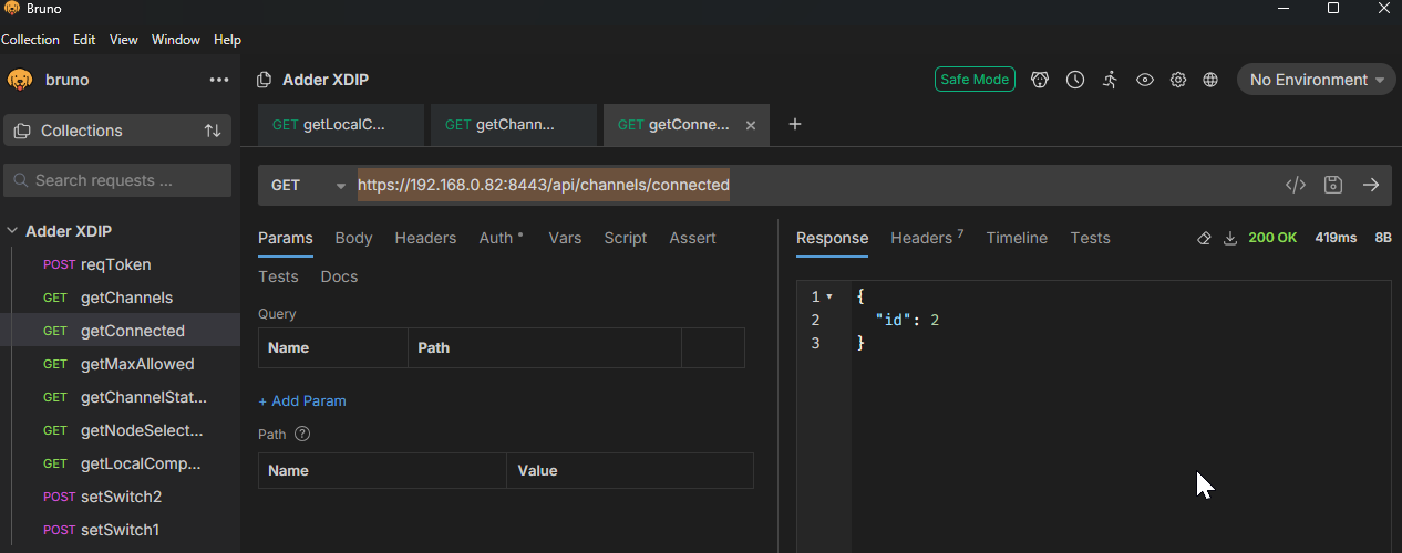

You'll want to either set the 'include response' flag to false (which will just give you back the HTTP response body) or you can use JSON.stringify on result.value.

OK with null for data field, I don't get 404 :-)
Now just got to work out how to decode. JSON stringify() works if I don't add the result code flag at the end of the get request.
But seems to fail if I add the result codes, which were printing the 404 message ok in the previous message.
Thank you
Richard Hills

Hi Richard
An error 404 would be generated by the server on your device itself and, given that it works in a browser, there is no clear reason why the server would reply with that exception (they also don't show a 404 in their documentation for that endpoint). Your best bet would be to contact the manufacturer and ask them to provide an explanation.
The only thing you might try here is to set the argument after "application/json" to null instead of an empty string - for a GET the "data" field should always be null to avoid attempting to open a write connection to the HTTP endpoint.
James Peltzer
Sent: 06-24-2025 13:41
From: Richard Hills
Subject: SSL Certificates – Disable Hostname Validation
James,
Thank you for all your help so far. We have had to implement the custom hostname verifier as it is not possible to load custom certificates onto the XDIP units. We have cleared this with the client.
This has sorted the SAN error message, but now I keep getting 404 messages for URLs validated in the browser and Bruno api testing tool.
function callback(result){
ogscript.debug(JSON.stringify(result))
ogscript.asyncHTTP("https://192.168.0.82:8443/api/channels/connected", "GET", "application/json", "", callback, true);this returns
{"responseCode":404,"url":"https://192.168.0.82:8443/api/channels/connected"}
Bruno retuns:
below was the http get generated by bruno
GET /api/channels/connected HTTP/1.1 Content-Type: application/json Host: 192.168.0.82:8443
The protocol documentation is on the following link Adder Support Wiki | XDIP: Using the API
What am I doing wrong? is this anything to do with the custom host name validator?
