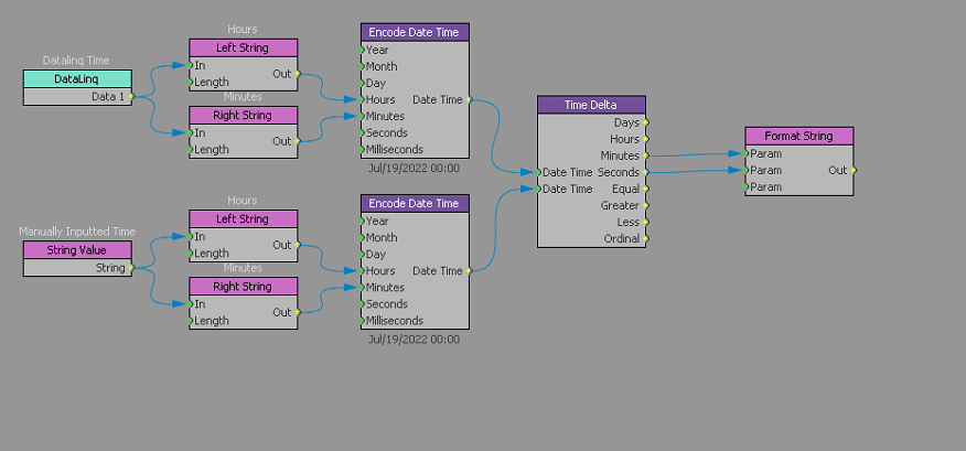

From: Jarod Valentin
Subject: Subtracting time in visual logic or script
I am primarily a designer and only occasionally dig into visual logic or scripting. I need to subtract a time (mm:ss) we receive from a Datalinq from a manually inputted time and have a field that has the difference in the same mm:ss format. If that makes sense any help would be greatly appreciated.
Jarod Valentin
