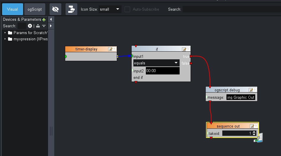

The DashBoard Visual Logic script looks like this:

I have a dashboard panel with 4 timers being used for rugby yellow card sin-bin timing. I have a scene containing a text object that receives the clock information from Dashboard (NOT an internal XPression clock). I am using XPression PRIME Go. The clock comes on via the main scene director, with a pause, followed by a "take offline" event. So, the timer comes on, and I then need the scene director to resume (or play on) once the timer reaches 00:00. I am struggling to get the visual logic to work. I've tried String Compare using the clocktimer text object and a string value block. Doesn't work. I've tried various other methods, both using numeric values and string values, and have come up empty every time. I'm running out of time, so if anybody has the secret knowledge, please share?
Here is a screenshot of my visual logic. The String Value is 00:00. Regardless of the clock's value, I'm getting a boolean of 1 all the time, even when the 2 are different.
