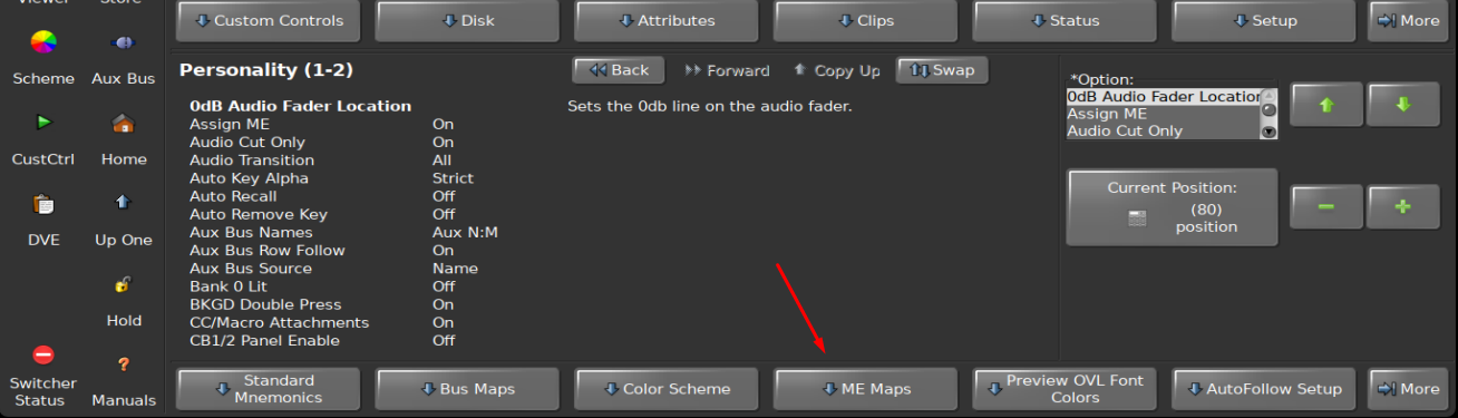

    In the Personality Menu there is a ME Maps Button and you can also do it really quickly on the Panel it's self

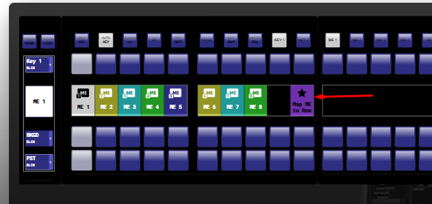

    So when you are assigning the ME you can also Tap that button shown to set that ME to this Row as the default for this Panel Connection.
    In the Personality Menu you will find:

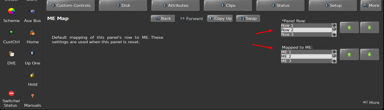

    Then you can pick the Row and the ME it is to default too.
    That should then Save with your set and be what is used going forward.

    I have tried both of your suggestions with no positive results. I have the ME maps under personality set but it doesn't boot up that way. I tried storing and recalling from disk but that does not change the assignment either.
    Pressing the "map ME to row" on the panel returns an error message "MEx: the button is not assigned" and that method does not persist through a reboot either.
