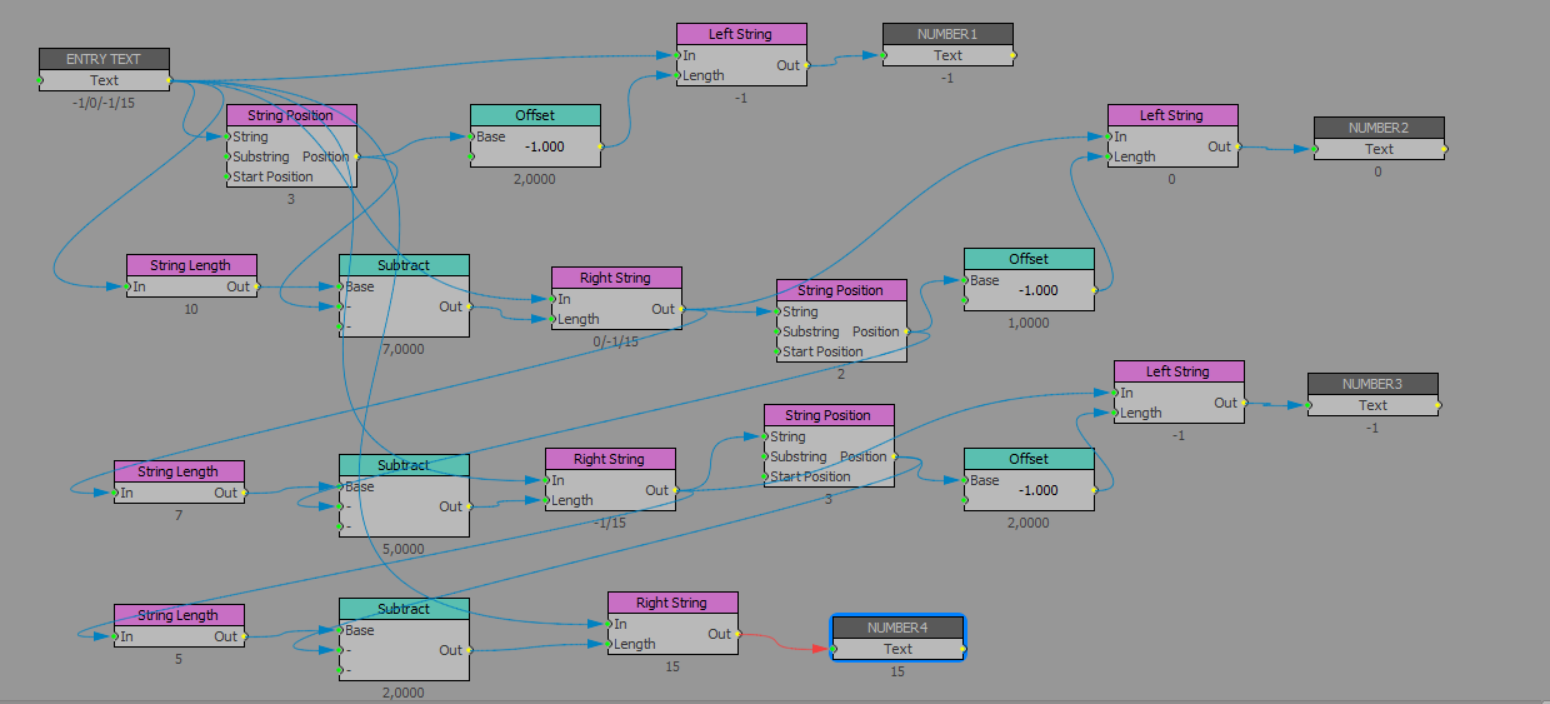

I have a string of text,
Presented in the form of -1/0/-1/15
I want to extract 4 texts from 01, 0, -1, and 15 respectively
Please note that each text is dynamic, and may be negative or positive, single or double digit
