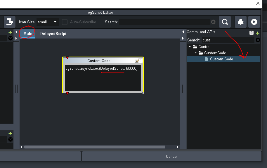

    The fastest way to run delayed script is to use our ogscript.asyncExec to run a function after a specified number of milliseconds.

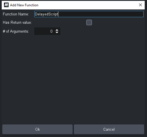

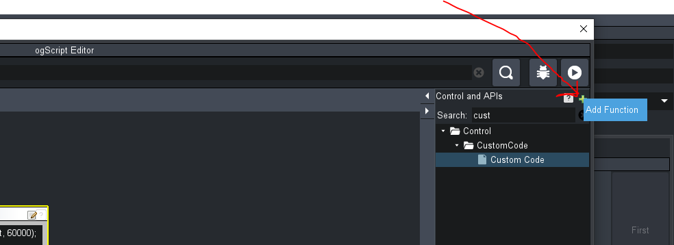

    To do this in Visual Logic, you will want to use the "Create Function" tool to create a custom function:

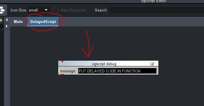

    Give your function a name like "TurnOffLights" or "DelayedScript"
    Put your functional code in the function:
    Back in your "Main" tab, use the Custom Code block to pass your function to our asyncExec code and tell it how many milliseconds to delay:
